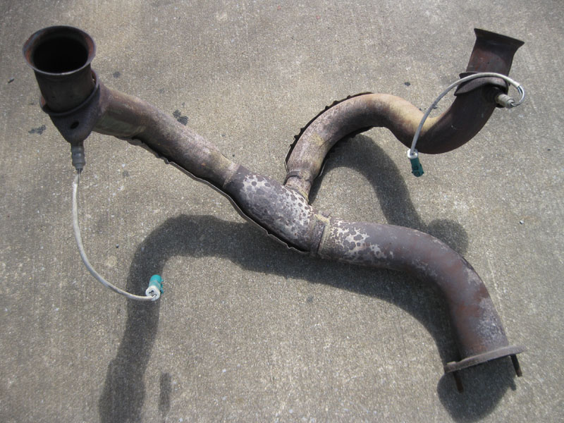

Another popular mod that adds noticeable power is to replace the y-pipe on the exhaust. Assuming yours looks like the one in this pic:
http://www.frontiernet.net/~jray77/0.../Y-Pipe-01.JPG
Some of the earlier gas engines had a little better design. If yours looks like the on in my pic, see the rest of my write-up here for what it takes to replace it:

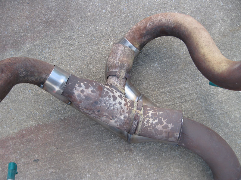

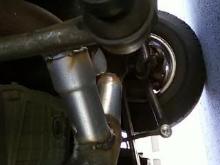

SPD Performance makes a replacement y-pipe that is very popular here. However, it requires welding to install it. There are no bolt on y-pipes available right now. I've also read about some folks taking their trucks to a muffler shop and getting them to fab one up that's more free flowing.
Original T-pipe
SPD Y-pipe

I think I remember measuring the restrictors ford put in there to be 1.25 inch on each downpipe. Heck my 600cc quad has a bigger head pipe!

Mine isn't as nice as the spd BUT it made a difference
