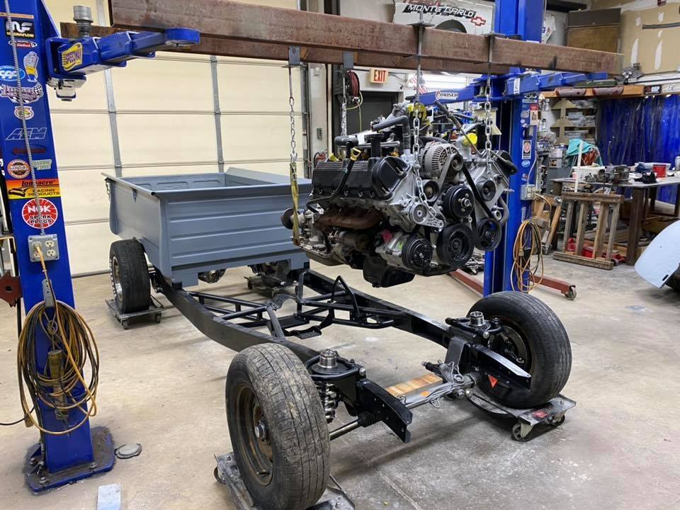

This thread is a little older, but thought I'd throw my experience in here for anyone looking in the future. I have a 1941 Pickup and I installed a 5.4L Triton and tranny from a 2000 F-150. There was no modification necessary at all to the inner fender wells. The only issue was the oil filter that sticks out to the side had to have a relocation kit to put the filter on the frame next to the engine. I did have to recess the firewall, but there's plenty of room for the stock exhaust manifolds, and everything else under the hood. Don't have the numbers for dimensions handy, but I'll post pics.

Thanks. At first glance you wouldn't think it would fit, but then you see that it does. Nice.
