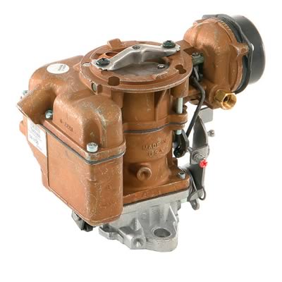

Is this your carb?
I found this one online, and it has 6-2228 on the side, so I am guessing it is similar to your carb.
In this picture, there is a threaded brass fitting in the choke housing. This is where the metal hot air tube attaches. There will be a small hole in the exhaust manifold for the other end of the tube to fit into (assuming you have the original manifold still).

That is basicly the carb I have. I got it to start better when hot and cold. I adjusted the choke so it opened all the way, but now it is a little harder to start when cold.
