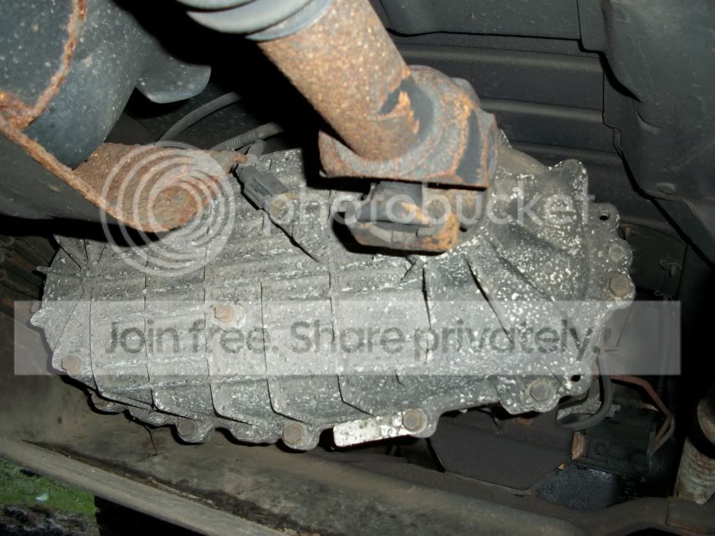

Hmmm....
Here's a *diagram*:
Here's a view of the side that faces the transmission:
Here's one (allegedly a 1345) in a JY:
There is a single wire that connects to the switch, I forget the size wrench for that switch
but it's fairly big, maybe 7/8"? You can see it there to the left of the drive shaft.
I can look at mine tomorrow morning but I'm guessing it looks like the one above.
The other possibility is gonna be a New Process variant which I believe looks something
like this (NP205):
Or like this (NP208):

I think I noticed that transfer case in the diagram lying on the ground under a truck i'ed say a 86 or so. I'll see what i can do . I guess I'll go back to the same yard and try and get that dome light wire harness and see if i can get the switch out I didn't bring my tools with me on the plane but maybe they will loan me a wrench. It looks like on the diagram that the switch is is on the back side near the rear drive shaft yoke no number. If the tag is still on the case will it say if it"s the BW-1345 it looked like the one in the diagram . Dose he still need one?. I'll try to PM him
dose the NP-208 have the same switch ?
thanks

I don't know if the NP switches are the same or not but I'd guess not; I don't remember
what those tags say but it's probably nothing that means anything to the naked eye.. I
would look for a ribbed case.
Quite honestly, there probably aren't many transfer case variants in this year range but
those transfer cases were used in vehicles besides Fords and more than 80-86 so you
might just happen upon one from a different truck.
