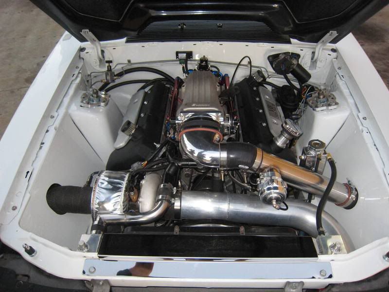

Here is one of our subaru kits we finished not too long ago. Twinscroll, Borg Warner turbo, Dual Tial wastegates, stainless and all v-band connections.

Originally Posted by SixtySix Ford
Just by a quick once over of this pic I see alot of things you shouldnt/dont do with a turbo.
Point it out

Originally Posted by crashtke
Oh, I see what you are talking about now. I could not see it on my phone yesterday. It is a water and oil cooled turbo. Most of the ball bearing turbos and even some of the journal bearing turbos are now water AND oil cooled.
Ok, just ignorance on my part. I thought that was what I was seeing but I didn't know any turbos were water cooled, all I had ever been around used oil only.

Originally Posted by RJP66F100
Someone tell me what he was doing with the top rad. hose in this pic.
From above FTE link
Originally Posted by chaser1602
Point it out
Just for starters.......
you should never run brake line for your oil/water feed lines to your turbo(s).
2nd, Im sorry but radiator cooling is crap in my opinion.
3rd, whats with the exhaust pipe radiator hose?? And where is that pipe running too?
4th, There is enough room under the hood for the turbo to have better placement.
5th Im just being picky here but I feel whoever built it could have done a better job
clean and simple

Is that one of those electric turbos in that pipe?
http://i116.photobucket.com/albums/o...Flowers002.jpg
you should never run brake line for your oil/water feed lines to your turbo(s). Y not?
Because brake line doesnt flex with engine torque. And what do you mean by electric turbo??

Old Dec 13, 2010 | 07:14 AM
  #42
crashtke's Avatar
crashtke
Joined: Sep 2010
Posts: 193
From: Atlanta, Georgia
Pressure in the system allows it to continue to circulate and a mechanical thermostat will still open. It is not being pumped, but the water passages are large and open enough to allow thermal movement without a pump. I have spoken with turbo engineers about this as I am leary of oil and water cooled chras after having the two mix when a turbo went bad.
