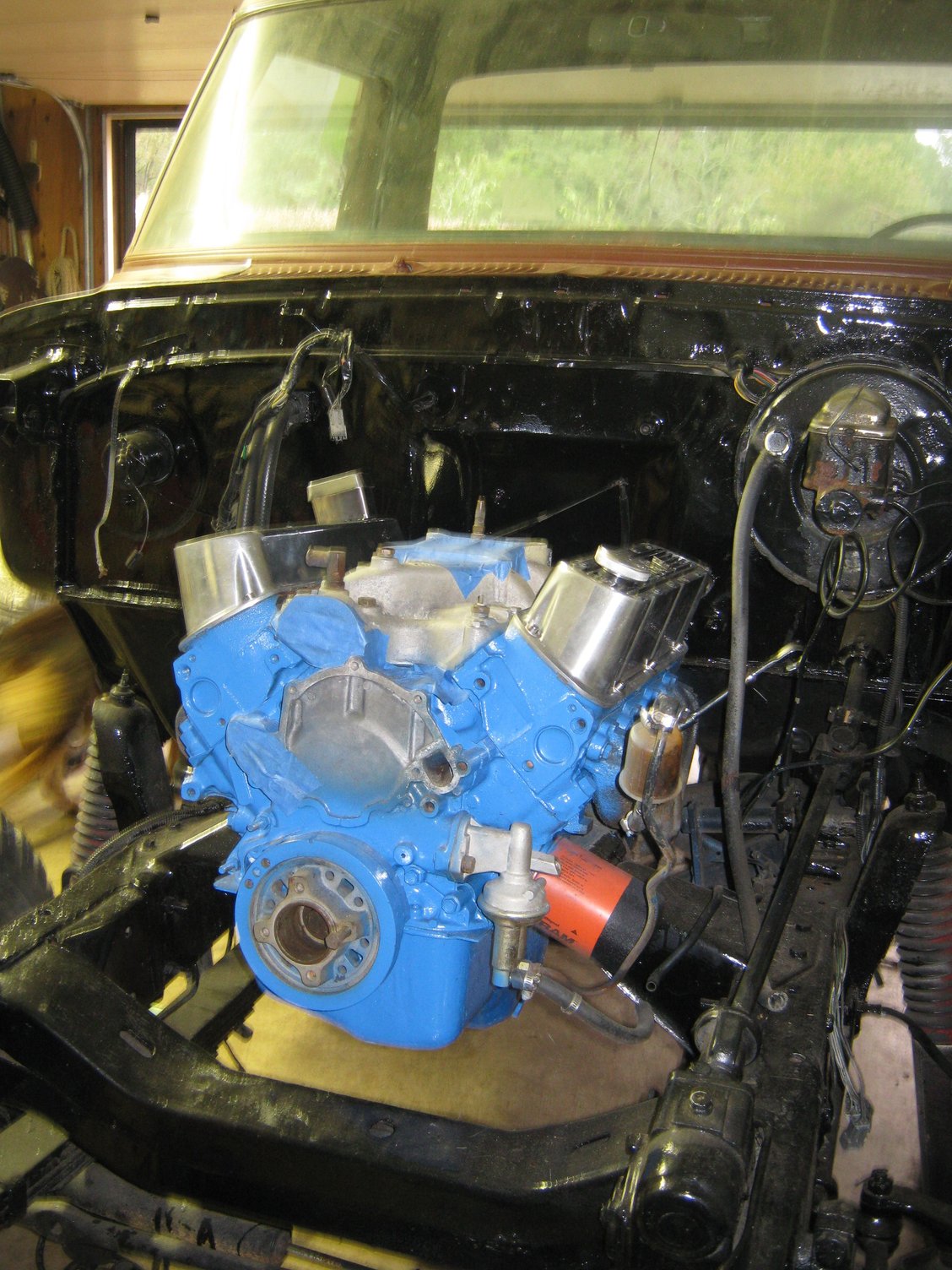

I ran a 302 for years with my F250 4x4 same towers as my 360,,,,,,,I had the motor from my f100,,,,,,
