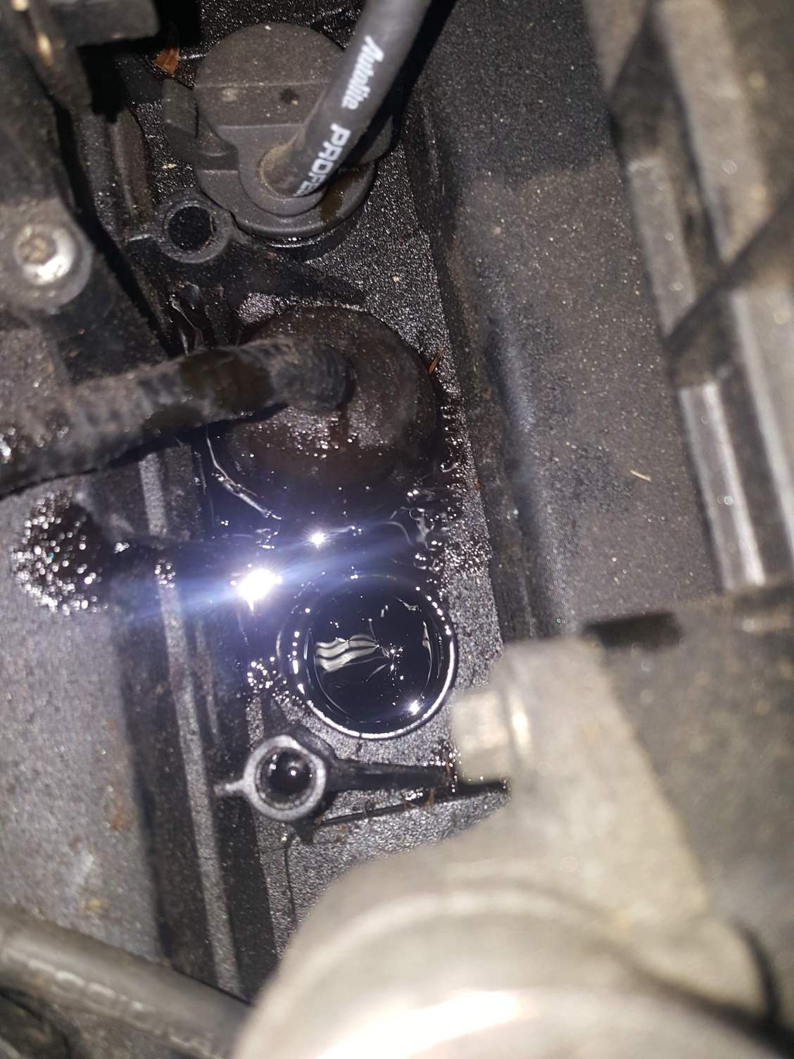

Thank you for the reply. I think I may have found an issue. I went to change the plugs today, First on closest to front looked fine from top, but plen I pulled the plug, looks like oil coated the whole threads, changed that and moved to the next one, OIL FILLED THE WHOLE SPARK PLUG WHOLE, couldnt even see the plug. so yea... I have a bigger issue now. any ideas on what to do about that?

Good find & a good example of why sometimes a picture is worth a thousand words!!! SO, lets think about what we might be seeing in the photos. Several things come to mind, loose cam cover fasteners, dry rotted spark plug well & or cam cover gasket/seals, excessive piston ring blow-by & or gummed up sticking closed/faulty PCV valve, or some combination there-of, that's causing crankcase over pressure, that's forcing oil past the gasket/seals.
The spark plug insulator looks clean, so worn, or stuck piston rings, causing excessive blow-by, at this point don't seem worthy of a spot high up on the suspect list.
So that kinda leaves the PCV valve, loose cam cover fasteners, or faulty gasket/seals on the suspect list.
Some thoughts for consideration, let us know what you find.

Thanks for the reply. I'm going to change out the gasket and PCV valve first.
https://www.fordpartsgiant.com/parts...d-cover,,6K260
Is this the right part? I'll also check the bolts for tightness
