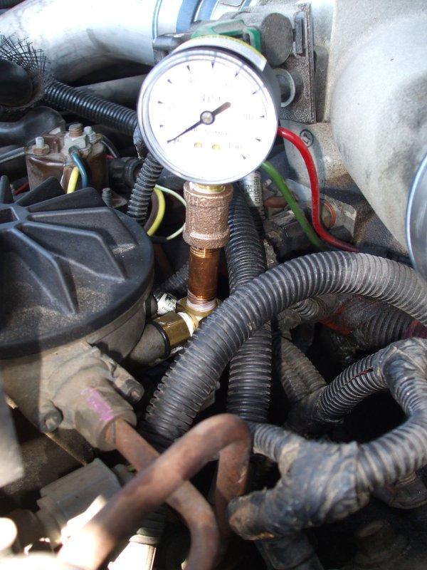

Now, Does any body here in the 94-97 forum know the easiest way to moniter fuel pressure on a 2002 truck?
Name:  Fuel pressure gauge 99 up.jpg
Size:  84.1 KB.................

Originally Posted by Action4478
Attachment 30239.................
Very nice! Thank you!

I took a fuel bowl lid and ground out the fins to accept a brass valve stem in the top. I don't leave it on the truck as its my tester but it works good.
As for the hard start. How are the batteries? Do they test any where close to marginal? I have had a number of trucks that start hard like you say but the batteries test ok but they are on the edge. New Batteries and it starts like a champ. They even sound like the engine cranks over good but between the starter and the GP's its just too much to start well.
I had seen the valve stem idea before and may try that, but I really would like to be able to moniter it on a test drive, but we'll see.
