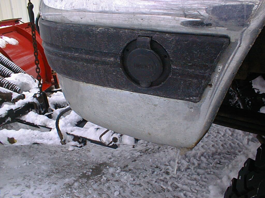

Looking to do the block heater mod. Which is when you mount the plug on the front bumper to eliminate the cord. Anyone have a link to the write up?? Thanks guys

I saw a thread somewhere...I remember a lot of guy's are mounting a "wet" environment plug/cover to their driver side bumper and middle trim area.
Drilled, recessed and looks nice...can't remember the brand name!
I want to find one....my plug cover collects a little rain water...not good.

Found It...via Action4478
Marinco is the make.....

TJ Did it first & I think he did do a write up on it ,,,

TJ's write up on it is here ....

HAHAHAHAH! Cut the hole got the plug to fit...Then looked for my heater cord because its a southern truck......Well....It has a plug where it should be..FML!
