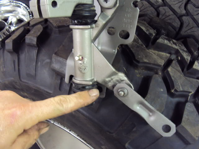

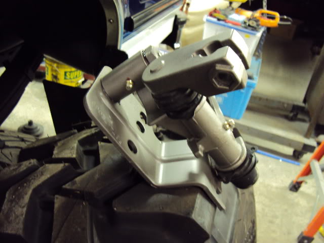

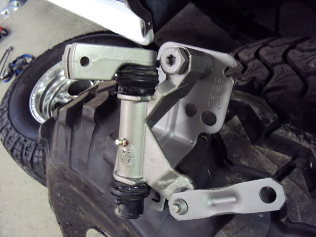

Not sure if this helps
But TJ drilled and tapped his and installed a grease zert in there.
Not sure if that would work here or not.
I was just perusing through reading this post and it reminded me of that.
His pics are not in there but I have a copy of the pic somewhere.
https://www.ford-trucks.com/forums/8...ml#post7593061
And now I scroll up and see all other other pics here with zerts-------------- lol
