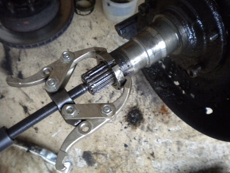

Nice pictures and description Rich. I just did my 78 bronco. It was a pain, as the drivers side outer bearing was destroyed and wouldn't come off the spindle. I spent some time beating it off.
On the passenger side, the hub wouldn't come out after the snap ring was removed. I had to use the allen screws and then pry it out slowly.

I have felt your pain before. That is the outer bearings inner race, the cage and rollers are ground up metal. Using a thin cut off wheel I cut the race, the spindle was ok. Had to get a new hub...
Trick for spindle removal next time. Tighten, rubber mallet spindle, tighten, tap, tighten, tap....
