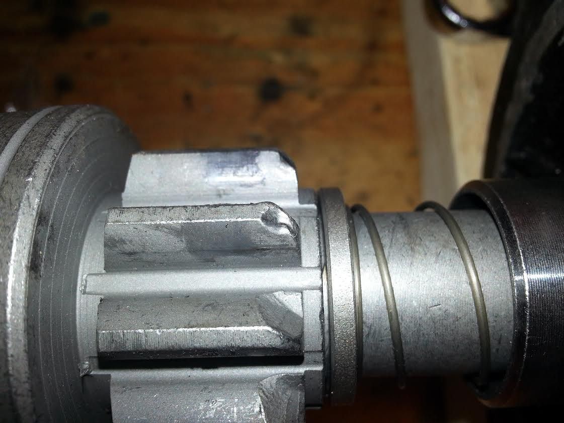

So I went ahead and installed the new bendix style starter drive. Turned the key and the engine turned with no grinding! But it didn't start. This is not abnormal when this truck sits for a while. I have it a quick squirt of starting fluid and she turned over fired a few times and stalled. Turned the key again and all I got was a click from the solenoid. The cable from the solenoid is fairly warm (never noticed that before). I thought it might be a low battery so I tried a starter box but it made no difference. Any ideas? Could I have killed the solenoid? Could the starter be jammed?

Well I tried the starter when I got home and it still didn't work. I removed the starter and inspected it but nothing seemed out of the ordinary. I removed a few metal filings that are the result of the original drive's grinding. I put the state back in and hooked up the wire (I did add a washer as the stud is partially striped. This time it started right up. I turned it off and restarted it several times with no issues. I am unclear what I did but it seems to be fixed. Thanks to all for the help. I will probably replace the 4 ga wire in the next couple of weeks just to be safe.
Looks like you have a bad ring gear on the flywheel (if it is a manual, flex plate if an auto). If you do have a flywheel you can flip over your ring gear and get more years out of it. The old starter drive probably hammered the crap out of it and now you are beating up the new starter drive. A bunch of work ahead of you if you want to fix it right but at least it is easy work.
