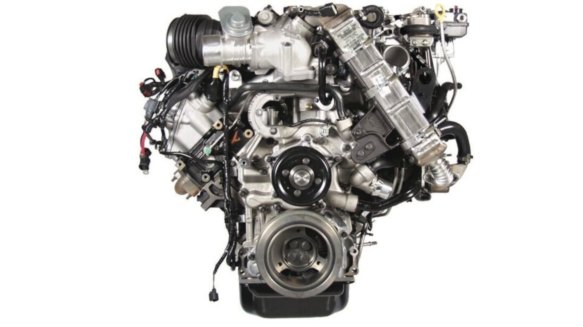

Oil Dilution
First up, we have oil dilution, which is the phenomenon that occurs when diesel fuel mixes with the engine oil during the active regeneration process. The 6.4 injects fuel into the exhaust stream to help combustion during the regen process, but oftentimes, it doesn't all get used up, and winds up contaminating the oil - which ultimately leads to more wear and tear on internal components, and ultimately, engine failure. This means owners should keep a close eye on oil levels, and use high-quality oil when changing it, too.
