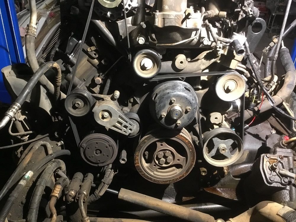

Step 4 - Lifetime Bulletproofing
If you plan on keeping your 6.0-powered truck forever and don't want to worry about the head gaskets ever again, there are some additional steps you can take. A proprietary head gasket coating, remanufactured cylinder heads, a coolant bypass system, and a tuner that monitors the engine constantly are all great investments in this case. These steps require significantly more investment and time, obviously. But in the end, you'll have a diesel that'll last a lifetime!
Figure 4. A completely bulletproof 6.0 should last a lifetime.
