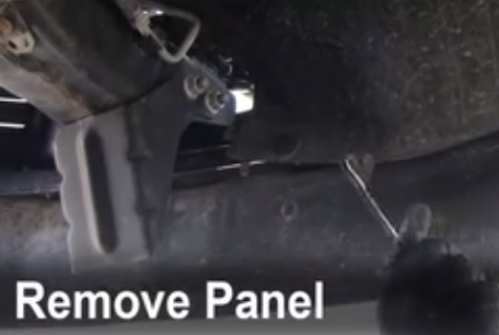

- Using a flathead screw driver or something similar, remove the splash guard covering the radiator from underneath to gain access to the radiator drain valve.
- Attach your rubber tubing to the drain valve port and then turn the port counter-clockwise to open it and allow the coolant to flow out.
Figure 1. Pry back splash guard to access radiator drain valve.
Figure 2. Radiator drain valve.
