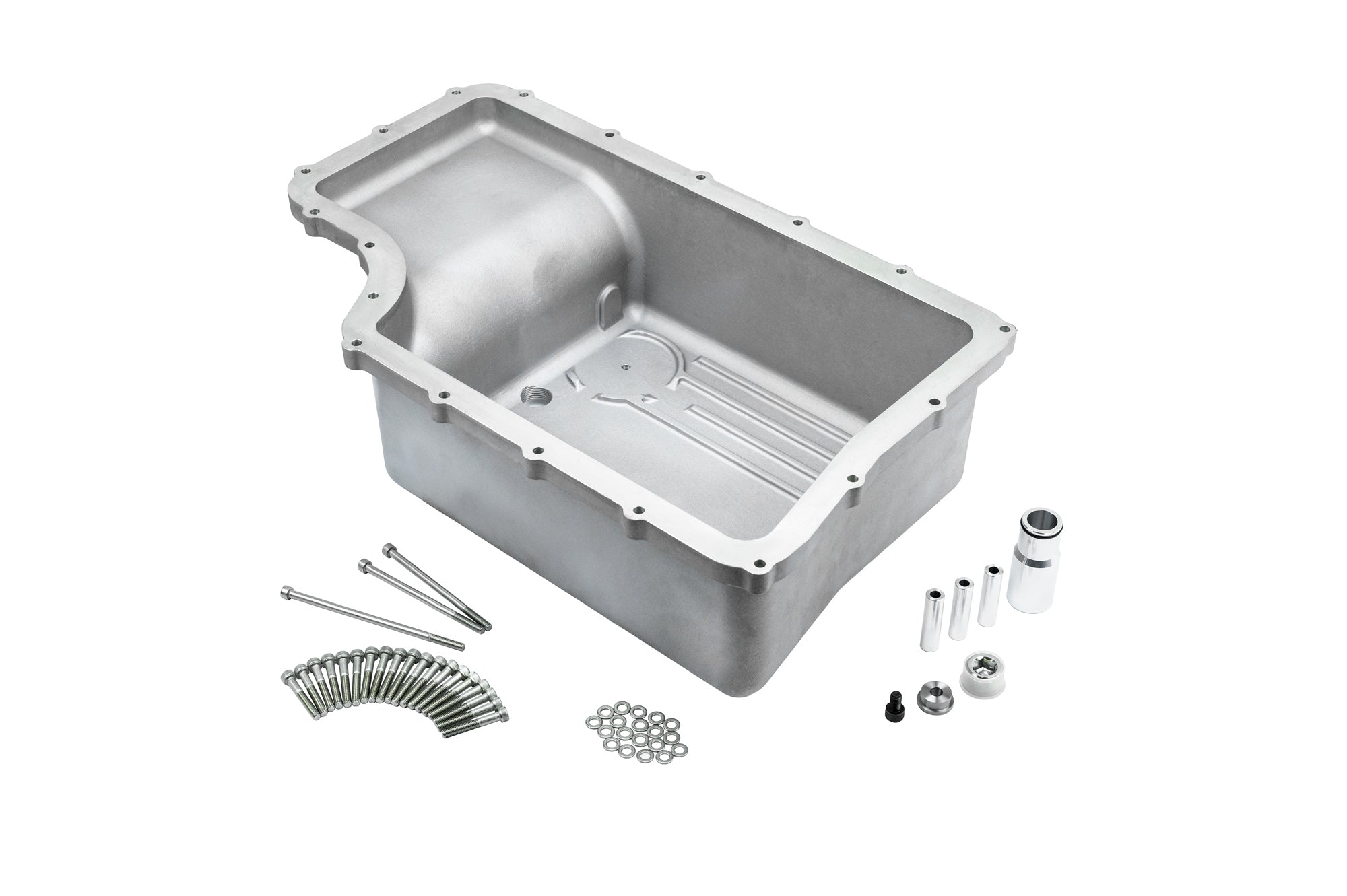

When I first started looking into aftermarket pans, I liked the B&M pan which adds just under 4 additional quarts... it includes filter spacers and longer bolts, and also the capacity to retain the factory donut magnet.
I have a few K&J Magnetics high temp rare earth magnets in my stock pan.
Then I saw the Goerend trans pan which adds 4 complete quarts... no spacers nor option to retain the magnet.

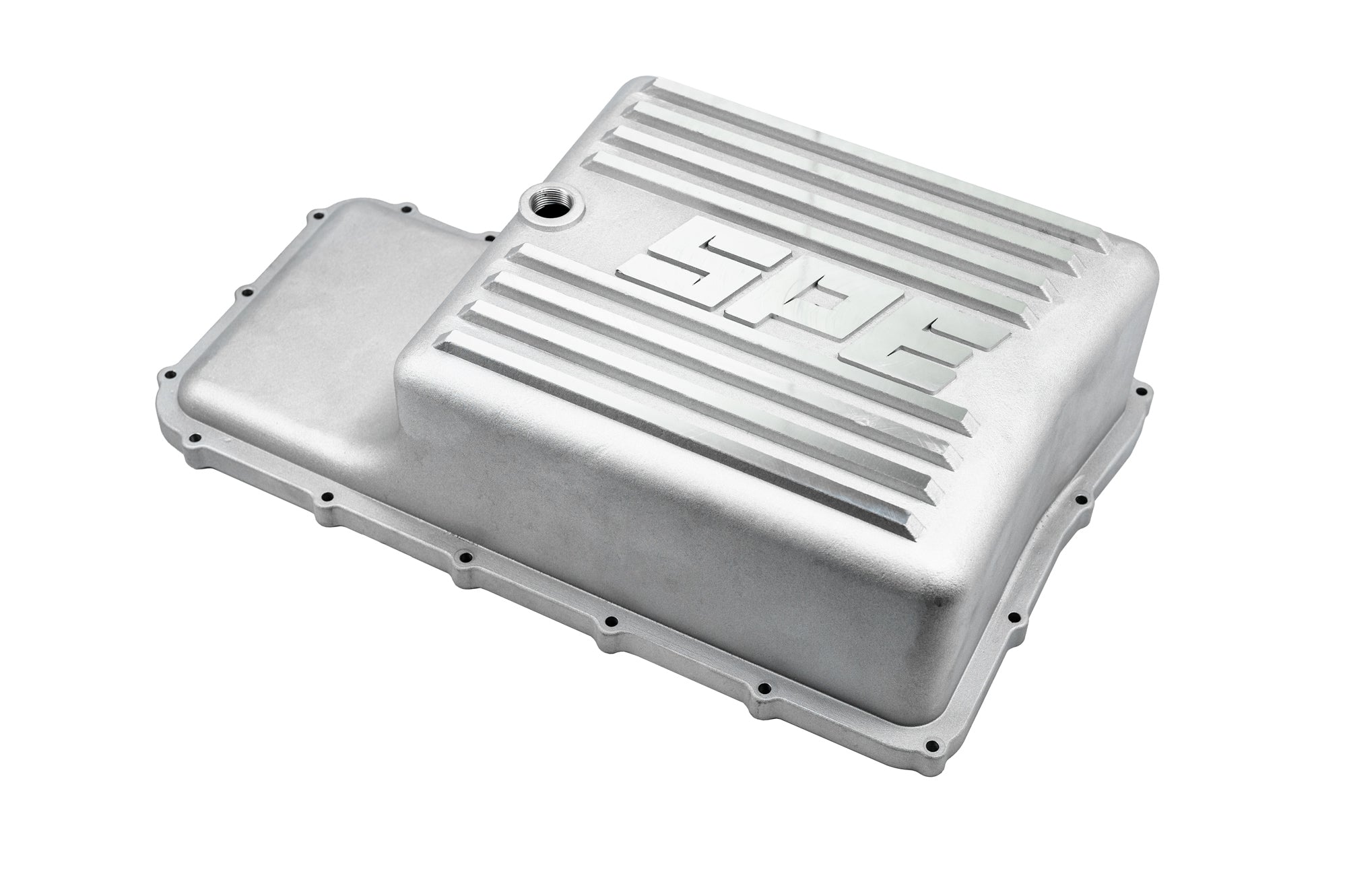

I have seen but never considered the SPE aluminum trans pan. It includes filter spacers and longer bolts also, the capacity to retain the donut magnet as well but adds an additional 8 quarts... I like that...
So when I reach the end of 50k miles, I will most likely go with the SPE pan... an even two cases of Mercon LV fluid... the more the merrier IMO.
I also will buy SPE's larger 6R140 trans cooler and their set of trans lines. I'll have to remove my plow frame to get off the lowest line from the factory trans cooler because the plow frame sits right on the plastic factory fitting keeper... I'll grind down the bracket in that location to avoid that moving forward.

Originally Posted by Overkill2
My last trans pan drop, the fluid was around 50k miles. Meant to change sooner but the sample came back good. I used LubeGard Platinum additive this time along with their newer aluminum protection additive (for the first time).
Going to go out to 50k miles again and do a pan drop and filter change at that time. I will also take a sample.
B&M's 6R140 pan.
Goerend's 6R140 pan.
SPE's 6R140 pan.
