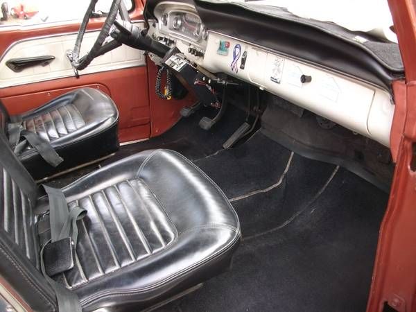

The foam was slightly firmer for 1966 but otherwise the same contours.
Here's the seats in a 1966 with the 1T81 code. Virtually indistinguishable from the 1965 black choice. These are original covers and carpets - a fairly well-preserved example. Special order paint, too, thus the blank color code. A Seattle (74 district sales office) native originally but it sold and was for sale again shortly after in a Kansas craigslist ad for way more money.
