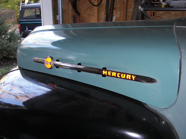

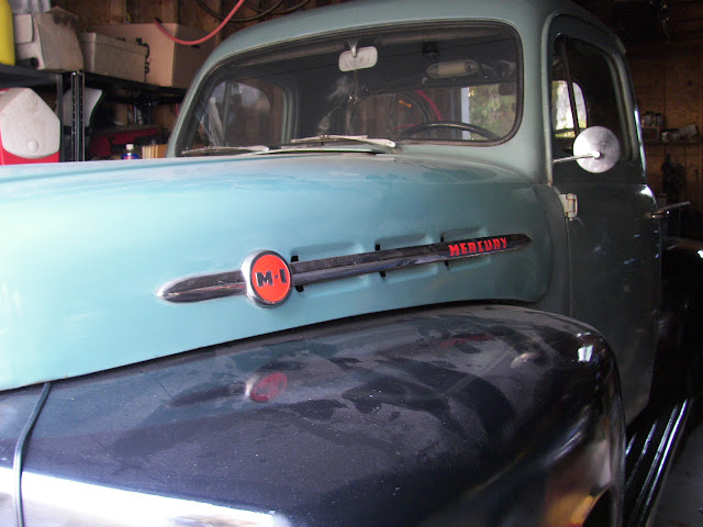

reflective hood spears
Having been rear-ended three times (not in my old truck) by people distracted by their cell phones has made me leary of driving without being extra visible.
The reflective tape on my tailgate looked so good that it got me to thinking where else I can use it. My latest is to do the lettering on my hood spears with red reflective tape:
With my camera flash it changes colours:
In real life it is very bright!

Talking how to
Originally Posted by 51PanelMan
Care to divulge the secrets on how you did it and what tape you used? I like the look of yours and would like to do the same on my 52 Panel.
I snapped digital pictures of the things that I wanted to reproduce. I was careful to take the pictures perpendicular to the surfaces so as not to distort them. Best to take this kind of picture with a fairly long focal length. (step back and zoom in).
I imported the images into AutoCad and traced the edges. (A person could use any graphic program, not necessarily AutoCad.) I printed the outline characters full size and laid them over red 3M Scotchlite Graphic Film (reflective material) and cut out the characters with my X-Acto knife.
