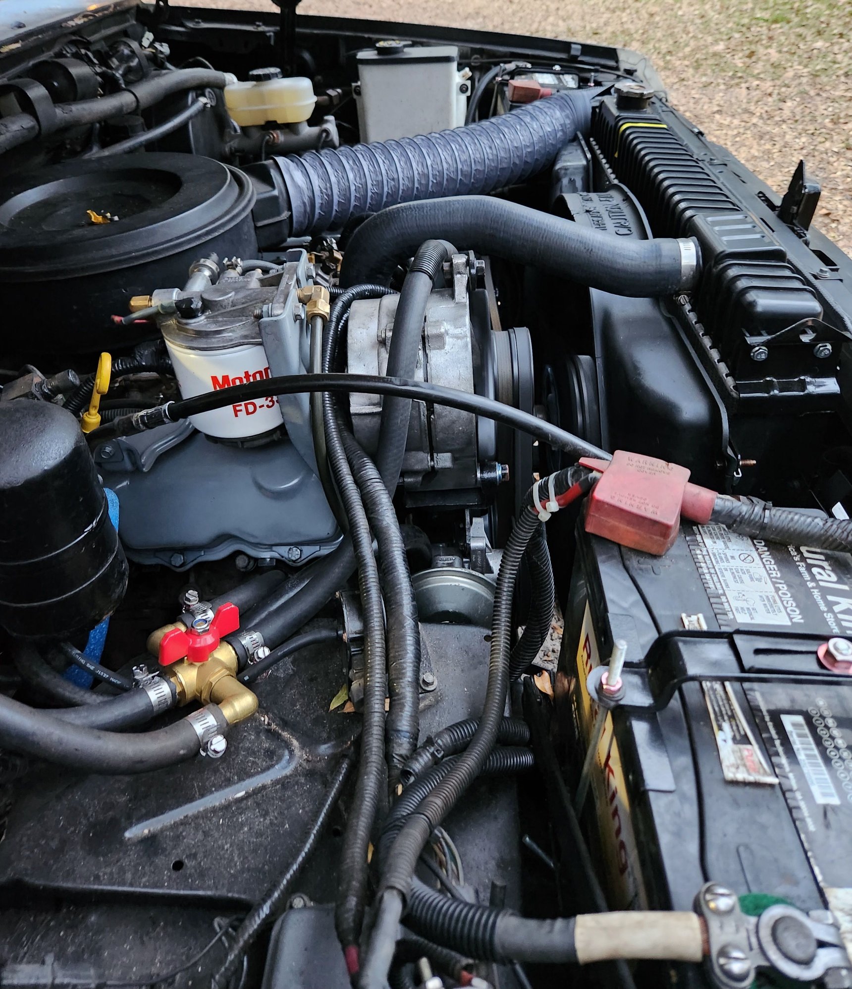

Just uploaded pic. Valve is from Amazon and seems decent quality. Been on for quite a while and no leaks.

I can see the picture, Didn't know they had a hand operated valve for that, quite nice. I have one of the vacuum operated ones off newer vehicles. I think I swapped the vac line that is used to recirculate the cab air, used only on the MAX AC setting in my truck. Works well enough though.
Can you add a link to the amazon valve you used so its easier for others to find?

I saw the pic now. Thanks! Appreciate ur effort. Could I just put another valve on the other heater hose, like the one I have on it now? I would just have two handles that would be turned off…

Nevermind, I think I get now. The other valve lets it continue to circulate. Duh 😊
Just order it. Same one as in pic. 23.99.

Outside of this discussion, but I couldn't help but notice the valve in your heater hose. Great idea, but it should be a 4-port bypass valve so coolant flows properly in system. Many reasons why on different vehicles, t-stat warm up, localized heating of cylinder head, etc, etc.
But cutting off the hot water to the HVAC is definitely a plus. Especially with the older systems and even more in a hot climate.
I got the 4 port valve today. Any advice on which hose goes where. I might b over thinking it bc I want to do it right
Update. Think I got it. Saw a YouTube video. 😊
