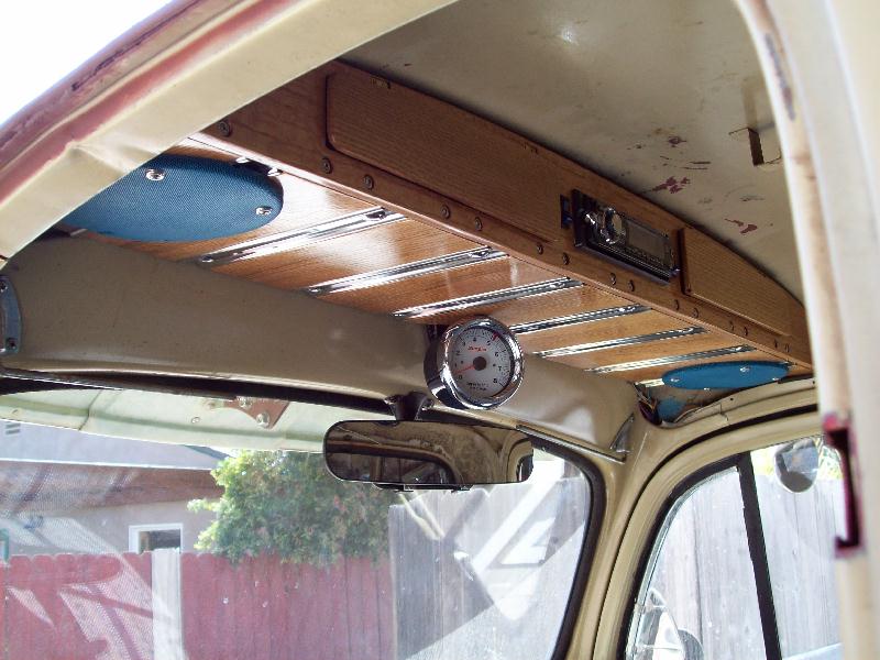

Or if you want something modern without cutting the dash youcould always go with something in the glove box, under the seat or in a Stereo deck like mine:

Here is what I did. I didn't really want to listen to AM radio, even if I could find an original. To cheap to pay for one of the conversions. Most of my music is already in MP3 format on the computer ready to load on an iPod or other MP3 player.
I looked for and found an MP3 amplified speaker system that runs off 4 AAA batteries (6 volts). Cost me around $25 shipped online.
I cut a board to fit where the original speaker mounted and fitted the speakers with a simple strap across the case to the board, foam was just to keep them from sliding around.
Painted the board semi black so the speakers don't stand out when the grill is on.
I cut the wall wart off the wire and connected it to the ignition switch (be sure to use the right polarity), tucked the small amp up beside of the glove box and wedged it in (I can actually reach the on/off switch through the ash tray but I just leave it on). Ran the phone jack into the ash tray, where I can plug in my iPod and just let it ride in the tray.
Works good, an old pickup isn't the right acoustics for HiFi but it is as good or better to the original radio for sound and I get to pick my cruising music.
