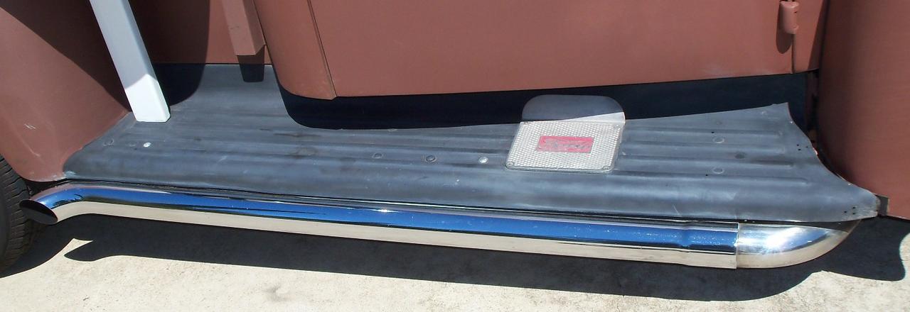

Just FYI, if those bolts that have the rounded head and the square section between the head and the threads, those are called "Carraige Bolts" just in case you want to ask someone where they may be.
You would use a regular "Hex Head" bolt to secure the running board barckets to the frame, and definately use the "Carraige Bolts" to affix the running board to the running board bracket..Those do not need to be "fine" thread..See the pics below. The carraige bolts holding on the running board are painted black (nickle sized round spots) and are in pairs about a foot ahead and behind the step plate. The silver carraige bolts are holding on the side pipes.

There may be a couple extra ones on the running boards that are there just to plug old holes.
