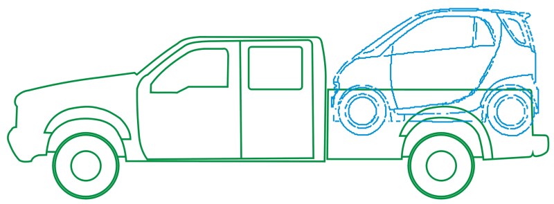

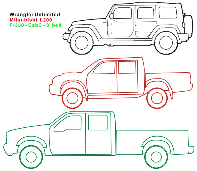

I made this line art to compare the F-350 to my L200, that I already have some trouble to find parking spots.

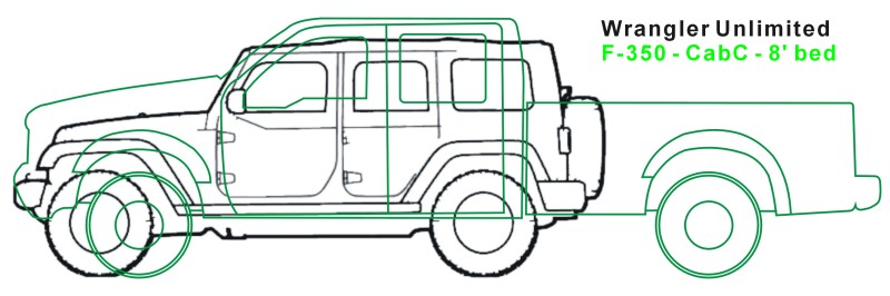

And here the Wrangler "in front" of the F-350
