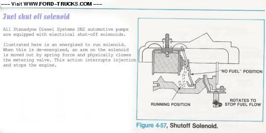

This might help you some. I wonder if it is possible for the metering valve to be sticking.
