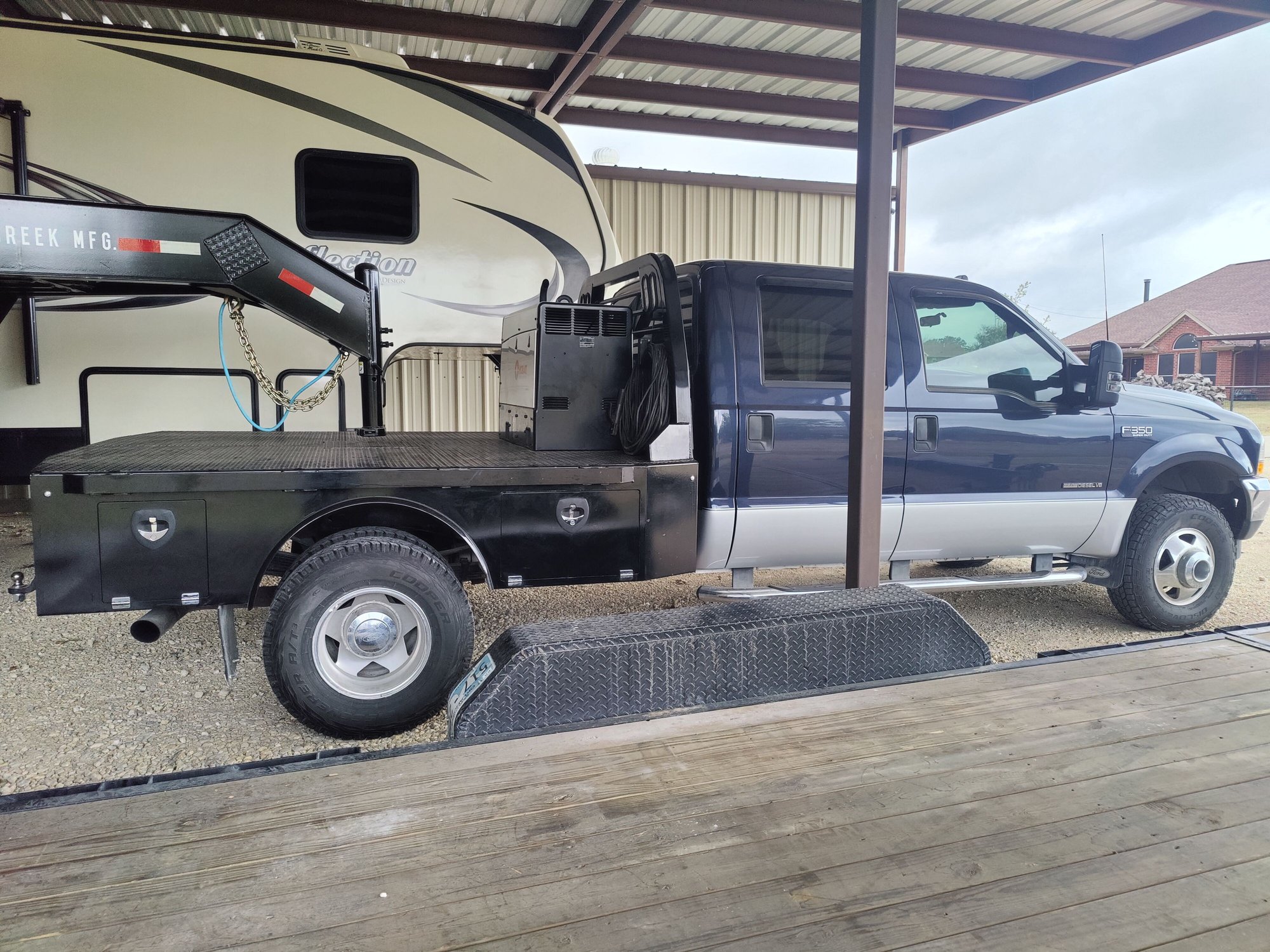

Here are some pictures of a F350 dually with 43-1263HD springs from ATS. The truck originally came with V code springs. The steel flat bed weights in at 1,600 pounds. The front of the truck has X code springs
With the steel bed on the truck, the 43-1263HD springs added 2 1/4" of height and fixed the driver side lean of 1/2". I did move the over load spring from the stock spring to the new spring. Over all these have provided a MUCH better towing experience.
