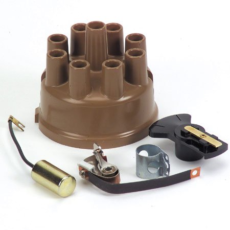

Like Bill said (in condensed form), yes, all Ford points and cap/rotor from before the 60's through 1973 are the same except the dual-point dizzys. 1974 and up with points, and 1974 cap/rotor until 1976 or so (small diameter) are the same. The HD truck engines like the FT that used points are the same thing too. The large diameter cap/rotor can be used on the older distributors too, I believe.
For the record, marine distributors made by Prestolite that use a clip-on cap use a cap/rotor that are the same as Ford, and use brass inserts and rotor tip, which can be hard to find unless you go to the "heavy duty" or "performance" cap/rotor. You can find these caps/rotors in marine stores sitting on a shelf somewhere getting dusty because they overstocked 20 years ago Not sure about the points, it looks slightly different:
