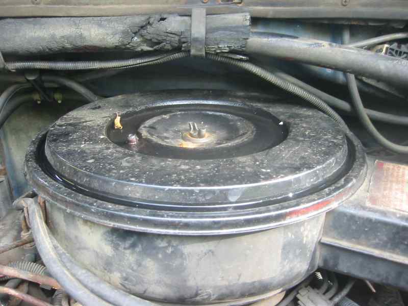

Yes, I got lucky with the water, it would stop the starter cold. I would then wait for a while and then hit it again, eventually the liquid would leak out and the truck would start. Last time it happened truck was sitting for a long time, it was really full. I think it was then I burned out the starter, then I got under the truck with a breaker bar and turned the engine over about a 1/16" at a time. Could hear the liquid pushing past the rings...
I thought it was leaky injectors. Was told through this list the the 85 had a bad hood seal that allowed water to pool on the air filter and work in around wing nut. (When my father owned truck he drilled 1/4 hole in filter and just put a bolt on top. Removed bolt and squirted ether in... Notice picture where rusty bolt is, water leaked right on in, did not even have to squeeze past wing nut ) It was recommended that I buy an 87 filter because Ford solved that problem with the new filter... I secured a plastic cover over the filter to solve the problem. Hasn't locked up since.
