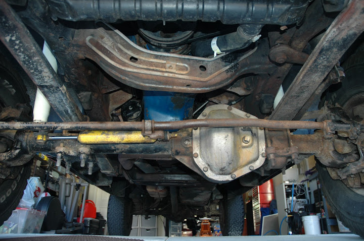

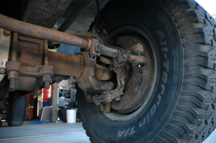

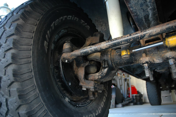

My 79 is a true factory F350 4X4 with Dana 60's front and rear but my front end has ball joints.
Old Jul 19, 2010 | 11:12 AM
Ronzi's Avatar
Ronzi
Joined: Feb 2008
Posts: 641
Likes: 25
From: Port Charlotte, Florida
Those are King pins
