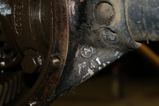

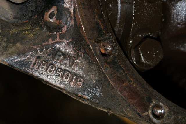

Old Jul 14, 2010 | 07:27 PM
ct50f1's Avatar
ct50f1
Joined: Dec 2009
Posts: 696
Likes: 48
From: Central Connecticut
Looks like it's a 41. Attached are some photos showing all of the numbers I've found so far.
