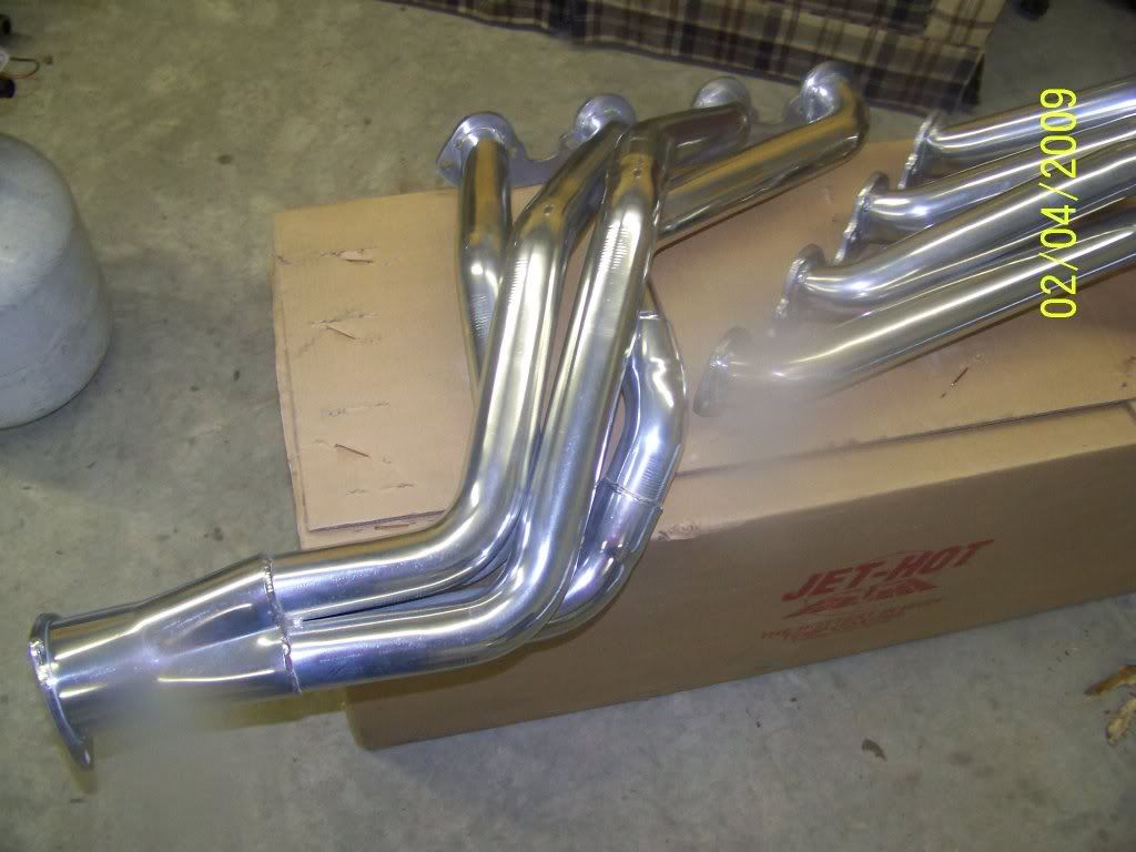

Do you know a company that makes fenderwell headers for that year for frame that uses carbureted heads?
Old Jul 4, 2010 | 12:38 AM
alpha/omega's Avatar
alpha/omega
Joined: Nov 2009
Posts: 7,669
Maddog Mad Dog Headers
badass headers but they must be coated. DO NOT paint them.

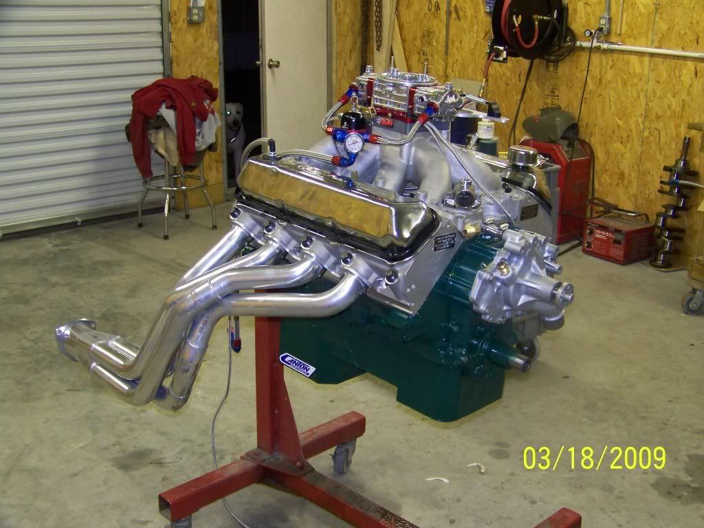

nice looking motor!!What's it going in?
Old Jul 4, 2010 | 07:01 AM
alpha/omega
Joined: Nov 2009
Posts: 7,669
its in my 79 250

Those headers fit your 79 but will they work on a 97 frame? The frames wider in 97 then it was is 79.
Old Jul 4, 2010 | 07:47 AM
alpha/omega
Joined: Nov 2009
Posts: 7,669
send Mark at Maddog an email. Im sure he can help you out.
