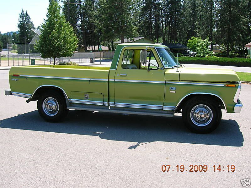

Yeah, They had F-350 140" Wheel-Base Trailer Specials. Very similar to The Super Camper Special, as they both had the Spare Tire Compartment.
'77-'79 Trailer Special Emblem, This was on the tailgate in about the center.
(I can read the part number, it is D6UB11402A16-AA.
(These can be bought from several sponsors of this site)
Here's a '77 ad:
Here's a '79 Cut-out:
'76 Cut-out: (Note: The 140" Wheel-Base)
Here's a '76 F-150 Trailer Special:
Here's a '74 F-350 Trailer Special:
Here's a '75 F-250 Trailer Special:
Here's a '74 F-250 Trailer Special:
