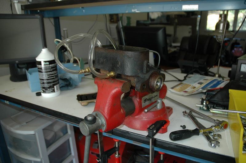

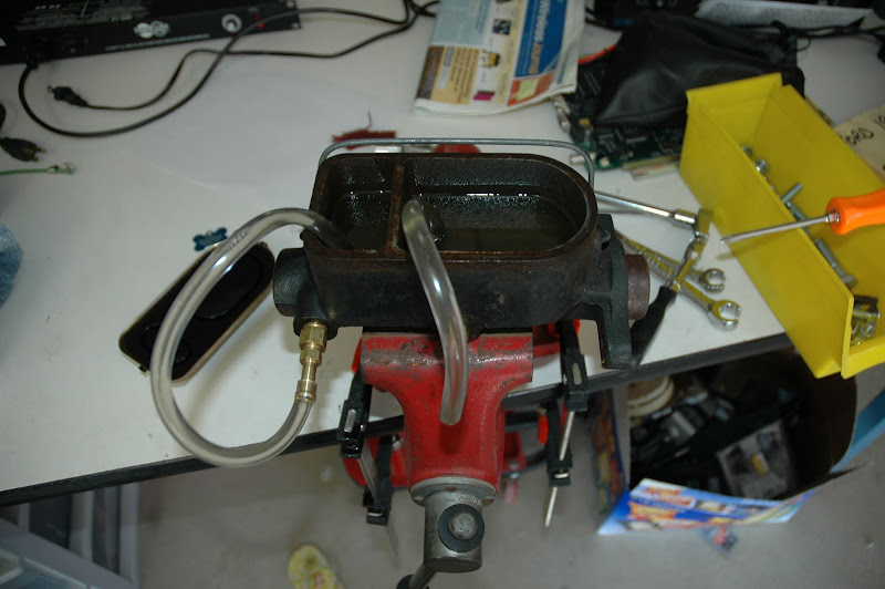

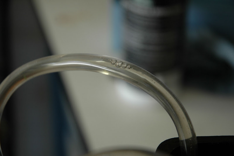

My wife still managed to thwart my Fathers Day weekend plans but I managed a few hours of work. I bench bleed the MC until ALL the bubbles where gone. I kept the reservoir full and my tubes in while I re-Installed the MC. Then I bleed the whole system again with one kid on the brake, the other filling the reservoir and myself under the truck.
The brakes still do the same thing. They will be nice and hard when pushed then slowly they will get spongy. Although this is my 3erd Master Cylider I am now convinced this one is bad. My next step is to buy a NEW MC from a real parts shop like Napa or AC Delco and not a re-built.
Here's a photo of the bench bleed process.
