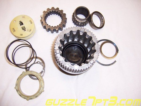

I would like to Thank Les again for donating a set of EOSF steel braided lines towards my project. I installed them yesterday evening while also taking apart my auto hubs to R&R them. Good news on the hubs is that I have figured out why one of them wasn't working. The bad news however is that I think I might need to replace the entire hub.
I have been on Parts Guy Ed's website and I can't even find the price of a auto hub or pieces for one. The part I have broken is the white nylon star shaped piece that is one of the first pieces to remove when taking the hub apart. I wish I could post up a picture but I am borrowing the girlfriend's laptop to even make this post.
I will try and give Ed a call tomorrow so I can get a hub on the way since I am assuming I can't order individual hub pieces.

I believe I only need one. Basically the ring around the nylon piece shattered away allowing the internals to run a wry in the hub, preventing even a manual locking.

Which part is it that you need, or I can send the entry hub for parts.
Old May 30, 2010 | 10:05 PM
Quick444's Avatar
Quick444
Joined: Jan 2006
Posts: 1,510
From: Anchorage, AK
Bottom left white nylon piece.
Is it worth replacing the bearings at this point or can I just lube them up? Also what kind of degreaser would clean these up well?

I mailed the hub parts out today using USPS.
You should have them friday. Let me know if they work out from you.

Just general brake cleaner should do the trick. Might have to use quite a bit as the grease will be thick but if you clean as much as you can with a putty knife and screw driver, it shouldn't be too hard of a job. If you would have access to a parts washer the job would be even easier. The stream under pressure would clean the bearings better. Or are you putting in new bearings?

This is what I used to clean them before I shipped them Gumout® - Carb + Choke Cleaner

Mark, got the parts today as anticipated. Its a rainy day here in Alaska so what a better time then to assemble my hubs and give them a real test?
Looks like I will pick up some brake cleaner and wash them out.
Thanks again Mark! This forum is absolutely fantastic!

So after all this my 4x4 is working quite well but I am having another problem. One of my hubs is physically tough to turn, it looks like the O-ring around the hub may have broken. Do I need to replace the external portion of the hub or is there a way I can fix this?

Can't you just replace the o-ring?

You don't.
See the big note half-way down this page:
Welcome to guzzle's 4x4 Autolock Hub Lubrication Maintenance Web Page
