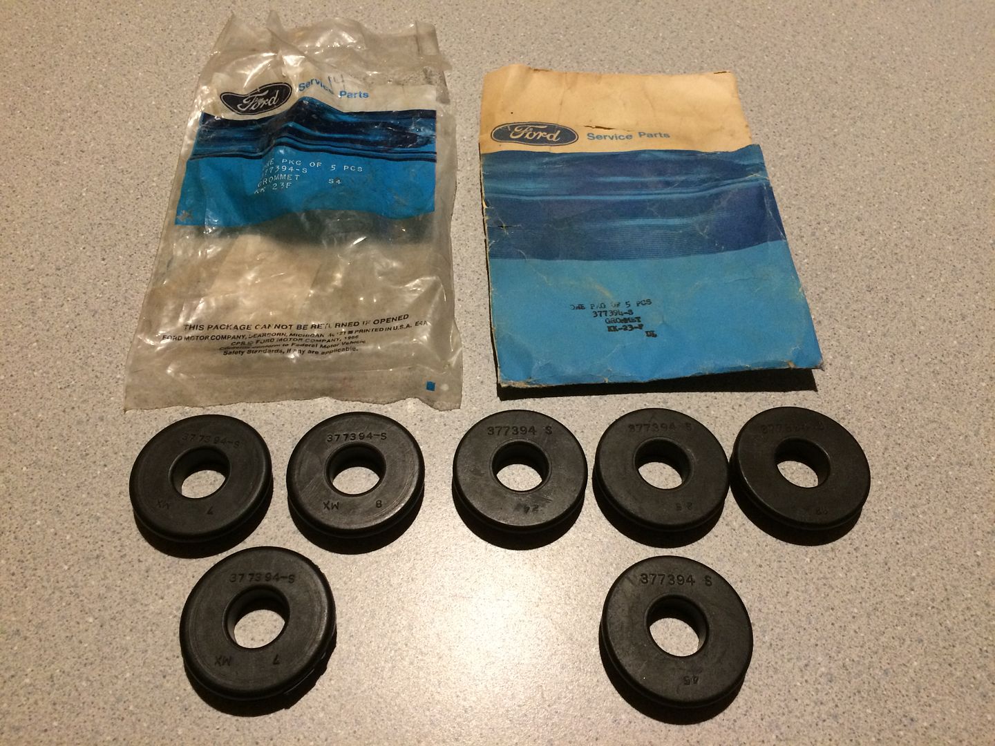

Originally Posted by OldHarley
The eBay auction for the C7AZ-6A892-B evidently is what the book says is correct for a 1966 352 truck.
It is not correct unless 1967 style valve covers are present.
1967: Ford replaced the FE valve covers used on 1965/66 F100/350's & Passenger Cars with 1967 "Powered by Ford" valve covers.
The following grommet is correct if the original 1965/66 "plain jane" valve covers are present:
377394-S .. Valve Cover Grommet (holds 6A666 [smog valve] to 6582 [valve cover]) / 1 7/16" O.D. x 23/32" I.D. / Obsolete
Applications: 1965/66 F100/350 352 / 1965/66 Ford/Merc Passenger Cars 352/390/410/428.
B. F. WHITE MOTOR CO. in Stanton TX has 2 = 800-953-3321.
JST AUTOMOTIVE in Lebanon TN has 10 = 615-443-3086.
KLIMESH MOTOR SALES in Calmar IA has 12 = 563-562-3241.
POCAHONTAS LINCOLN/MERCURY in Pocahontas 1A has 12 = 712-335-3363.
GREEN SALES CO. in Cincinnati OH has 91 = 800-543-4959.
Part number source: 1957/68 Ford Truck & 1965/72 Ford Passenger Car Parts Catalogs.

B was replaced by A - there is no indication that a quantity was involved - but as ND says those are for 1967 and newer vavle covers. The 377394-S should be correct for 1965/66 F100/350 352.

As NumberDummy notes B replaced A - there is no indication that a quantity was involved - but as ND says those are for 1967 and newer valve covers so make sure you are in that boat.
The OSI (Obsolete-Supercede-Interchange) manuals or OSI Ultrafiche (try finding a reader for Ultrafiche these days!) lists thousands of parts that were replaced by a newer part number (Superceded), not replaced at all (Obsolete) or mix with a different part number (Interchange) but it rarely gives effective dates and never a quantity.
As you can see the earlier grommets I pictured came in a package of 5 - the parts counter would still sell you 1 from the package if that's all you wanted.
Green Sales does sell reproduction stuff in some rare cases but they have always told me up front so I can choose if I want that or not. Sometimes they offer NOS or reproduction at different costs, too.
