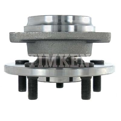

Greetings. I was thinking of upgrading the hub assembly on my D60. Maybe to something a little beefier. What are people using? Brands? Model?
The D60 is a non ABS (I believe) from a 1997 f350. It's under a 96 F250.
Thanks for anyones input.

By hubs i think you mean 4wd locking hubs. If i had the money Dynatrac DynaLoc Locking Hub
Thanks for the reply. I am looking to replace the entire assembly. The wheel bearings, etc.

Unless you have a 99-up superduty front axle , you dont have a complete hub like the one you showed. You have 4 individual bearings. there is no upgrade
Thanks for the info. I had seen a few upgrades but yeah, they were for 99+ SDs.
I guess I'll tear it apart and do the bearings then.
Thanks again.
