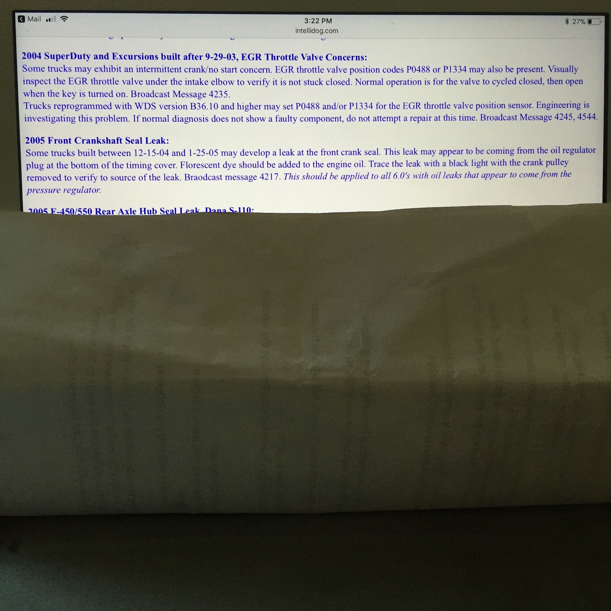

Sean did you get this taken care of ? What was the culprit , I’m showing a P1334 DTC , replaced the Egr valve , the code goes to the Potentiometer, better known as the TPS throttle plate sensor $205 later that’s not the problem either , it did give me better throttle response, but when engine warm driving for awhile and I come to a idle , The engine idle is rough , did you experience this rough idle aswell , the code still won’t clear after doing both these repairs.

Ok thank you for the reply , I have read somewhere the 04 tps and Egr Valve strategy is in cahoots with the EBP , I do have a New EBP for the truck I bought years ago , I’ll dig into that and see if the rough idle goes away , I’m not seeing anything weird on the gauges so this one has me Stumped
