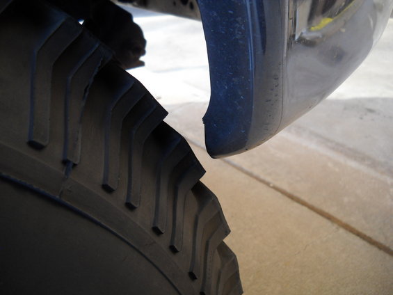

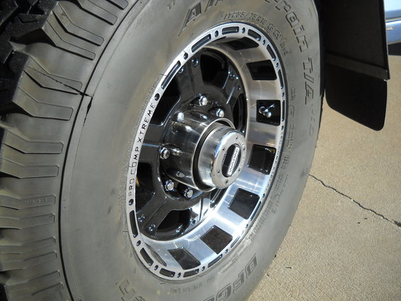

Even though the bolt pattern may be the same, I'm wondering if rims from an 85 will clear the front discs of your '96. I recently went from the stock Alcoa 7" rims to an 8" because 7" is too narrow for my 285s. I got a set of Pro-Comp 8089 black/machine rims. I think they look awesome. They clear suspension and fenders OK but I had to trim a bit off the bottom rear corners of the front bumper because they are offset a bit more to the outside than the Alcoas. Shimming the bumper forward with washers would work too.

Since you are into the pics.....Can you get about a 3' to 4' side shot of the front wheel / front bumper area & post it. I'l like to see that tire clearance to the bumper.

Can do Johnny - after I get home from work. I'll try to get a pic or 2 up this evening - around 6 or 7PM MDT. But don't let bumper clearance deter you. Even if you don't want to trim it like I did, you can always shim it forward.

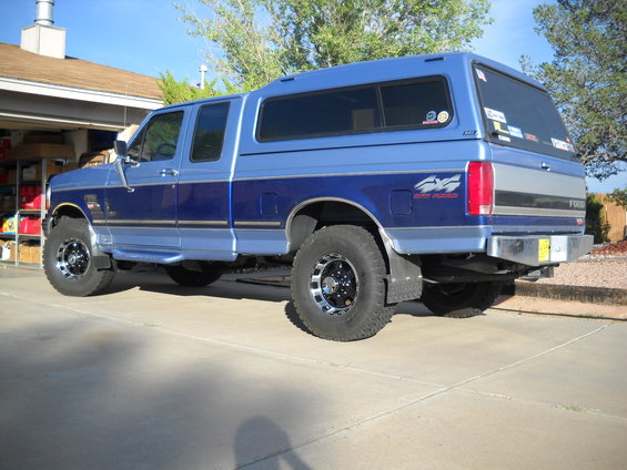

Johnny - Sorry for the delay. My neighbor was out when I got home. I went over and ended up talking to him for an hour and a half. Anyway here are shots showing the closest the tire gets to the mud flap (1in) and back of the front bumper (3/8). The last shot shows the strips I cut off the bumper. I just used a 4 1/2in angle grinder, then touched up the bare metal with primer. I really don't like the look of a bumper that's shimmed forward, unless there's a winch or something hanging on it. I never wheel her, or I might have concerns hitting that bumper when stuffing the tire. I hope this helps.

That helps....Thanks for the pics.
