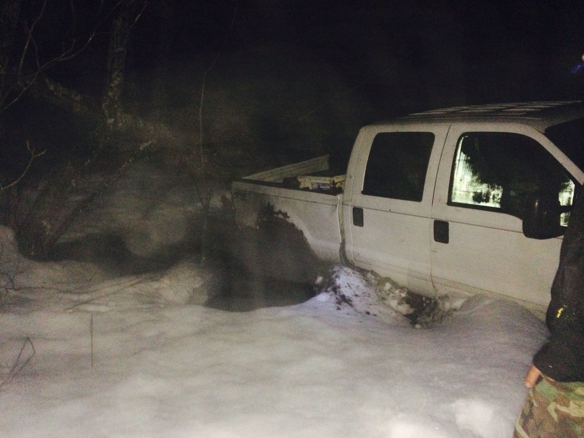

Do you think it would hold up to the truck it attached to if it weighs 9500 lb and I'm using a 12000 lb winch recently had to pull my truck out with a winch

Depends how you rig it. I would use a ****** block and tie off on the tow hook and some hard point straight ahead. You aren't pulling the whole weight like in a dead lift, but a lateral pull.
I have used mine in this fashion pulling more weight. I have also done some recoveries where the wrecker was too far away.
