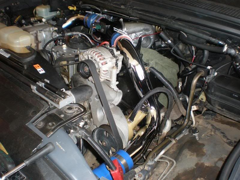

Now ya gotta admit this looks better

Brian, Them's purrrrrrrrdy pipes!!!!

Polished the ol pipes up mate,looks good..
Whats the gauge there for ?..
