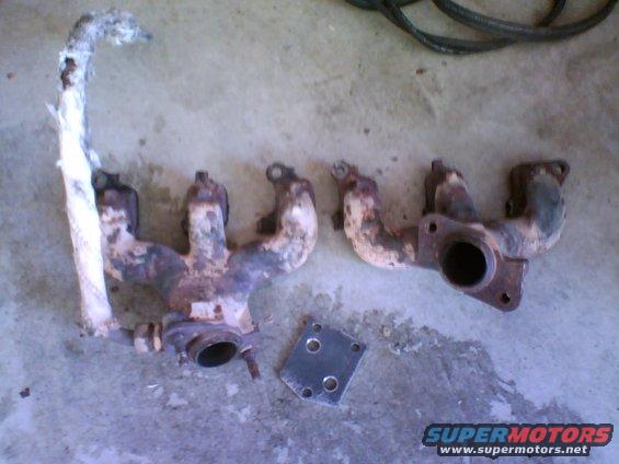

EFI is a 2 piece manifold non EFI is a 1 piece log type
as stated '87 and after have them and some grind'n might be order to make them fit proper
gonna need a Y pipe as well so get that and then think about what you want to do from the Y pipe out.

EFI Manifolds:
Stock LOG:
I was meaning, it's super easy to tell which engine is EFI just by looking at it. VERY different looking at a quick glance from carb.
