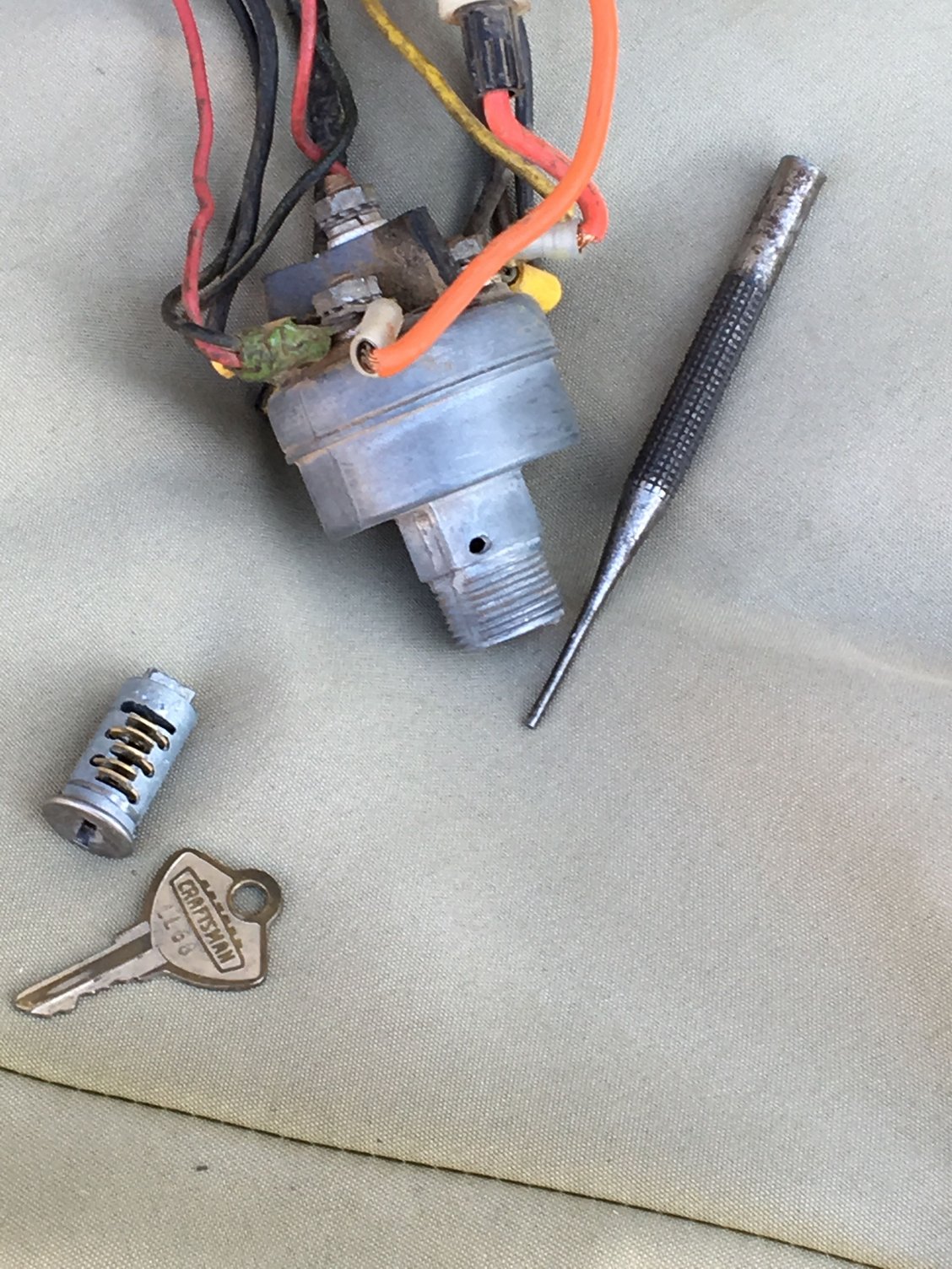

I pulled the lock cylinder from my 1956 F100 by pushing in the small hole just past the threads on the neck. Be careful as all the small keys will fall out. I got lucky and my Craftsman tool box key fit and I was able to turn it.
Note that this hole is not open and covered by a bit of casting. I knocked that out and then I could see the release spring when the key was in the accessory position.
