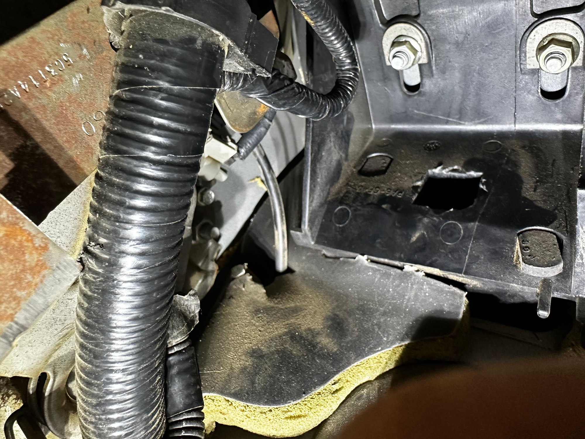

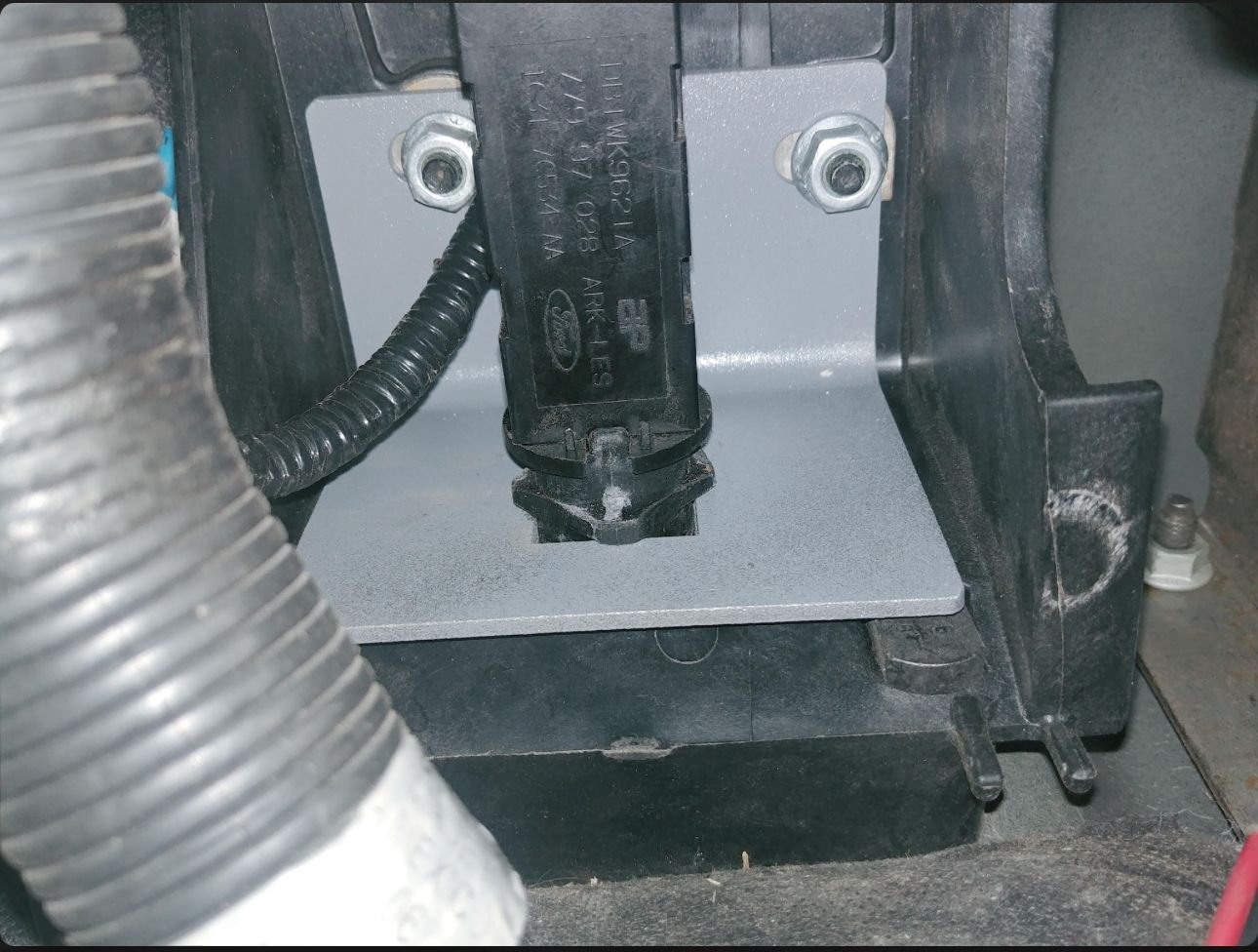

Clutch Master Cylinder reinforcement install
Just in case someone else runs into not having a reference, I’ll try to explain how i installed the South Bend Clutch reinforcement bracket. Sorry I don’t have pictures, my phone was in the house when motivation struck and i don’t stand in the way of motivation.😂 The original pedal box has to be removed. Four 13mm nuts- two under the dash and two outside on the firewall. You will inevitably drop one of the firewall nuts and will not be able to locate it. Three nuts for re-Installation is sufficient. Also, don’t destroy the fuse box located ridiculously close to the clutch master cylinder. Remove pedal assembly from your truck. You’ll see the area where the round backstop on the master cylinder touches the pedal assembly. You’ll have to cut this section out of the pedal assembly. I recommend making the hole a little larger than the circular pattern on the plastic shown on the pedal assembly. I used a grinder to cut a square out the plastic, yes it did cut into other parts of the plastic but motivation decided I was not concerned with the cosmetic atrocity I had just committed. I did try to use a hole saw but excessive bleeding during this procedure suggested using the grinder would be better for my own safety. After you butcher the required hole in the plastic, begin the reinstall. Since you only have three of the 13mm nuts now, pick which stud you want to secure with one nut- you may need to twist the assembly a bit to get both studs through the firewall. After you tighten the firewall nut, take the reinforcement bracket and another 13mm nut and yoga yourself into position to use one hand to hold the bracket and thread the nut on the stud. Then add the second nut. The holes on the bracket are slotted allowing right/left movement. Before you tighten, look through the square hole in the bracket to ensure you don’t have any obstruction to fish the master cylinder through. I could not use the tension spring on the master cylinder and get the assembly to twist into the new reinforcement bracket, so that was deleted. I actually filed the plastic on the round backstop of the master to make it fit in the new bracket. I also have de quervains in both wrists, so I ain’t the strongest. The flippin fuse box drove me absolutely insane due to this. I’d much rather replace a clutch than have to repeat this procedure again. Put the pushrod back on the clutch pedal to complete and hopefully enjoy this clusterfrig of a process.
The two nuts on the inside of the pedal assembly.
What the bracket looks like after assembly. I found this on another forum.

So...... not to sound like a critic, but that master cylinder, square part is supposed to go down into that square hole and then rotate 1/8 turn and lock itself into the mounting point with the square tabs behind that reinforced wall. Not in front of it as it is in the picture.
Much in the same way that the slave cylinder mounts in the bell housing of the transmission.
I don’t mind ANY experienced critic clarification!! This was only intended to help someone in the future, let’s make sure they get it done correctly! And, that would have been some useful information.😂😂😂 I thought about and fought the thing for literally three hours over the course of two days before the grinder came out. I couldn’t reverse engineer enough to make sense of the actual mounting process. I truly thought the tabs locked in on like the original plastic mount, minus the one flat corner on the master cylinder.
It does function like a clutch now, everything feels good and the creep is gone. 🤟🏻 Again, I can’t thank you all enough for the support and wisdom!!
