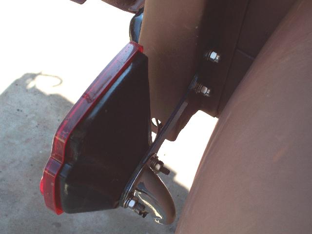

Yeah, I don't remember a short/ long option either, but that was also a long time ago. Here's a few pictures of my set up.
Its dirty as crap right now, so there's alot of bad reflections. Ive been driving it like it was meant to be driven, lately. The second pic shows where I had to cut and weld. I did scratch my paint a bit while figuring out what clearance I needed, but the rest is just wax that I don't take the time to get off. The plate/bracket doesn't hit the bed as it is shown.

Yes as you can see your photo's confirm one of the problems I noted earlier. You have the brackets mounted on the two upper bolts. If you had mounted them on the two lower bolts - as I mentioned in post #4 you wouldn't have run into exactly the problem you have. I mentioned it again in post #6. You have the long, straight, brackets and you have the bracket mounted on the correct side of the stake pocket.
Again, read the thread from the link I left on post #2. It explains and has pictures of the different brackets. This is an issue that comes up with newer folks that weren't arouind the last time the question was asked and answered.
Here's the difference when they are mounted correctly on the lower two bolts - the same two that hold the tailgate pin:
