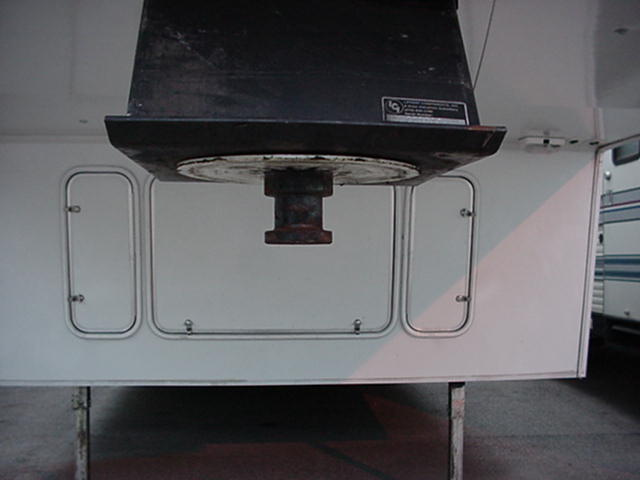

5th wheel
gooseneck (with improperly attached safety chains)

First off, why are attachment points so far back?
Second, (directly related to first), they should be crossed. A trick I learned to always prevent chain binding on unforseen turns and hills is to cross them, and wire them together, and to the tounge. Same reason you run the pigtail to the tounge before you to go the plug. The closer everything is to the axis of the hitch, the less things have to expand/slack while moving.

Originally Posted by dougbrown
What improper about the chains?
My trailer came equipped with a carabiner on each safety chain for attachment to the bed mounted hitch. I think this is what TexasRebel is referring to.
Also it appears that the emergency brake cable is connected to the chain hook and it should be connected to the bed.
good catch! I didn't even see that. It appears that the breakaway cable is wrapped around the chain, too. Rendering it useless. Not very many people take the time to cut their cable to the proper length.
This is a good question, all of the hitches I have seen have the safety chain attachments right next to the hitch. I wonder if the attachments are even connected to the frame.
Good to see that the battery operated brake is installed. According to my local trailer dealer, the DOT is really cracking down on trailers that do not have this installed. Unless you are carrying perishable goods they will ground you until the proper equipment is installed.
