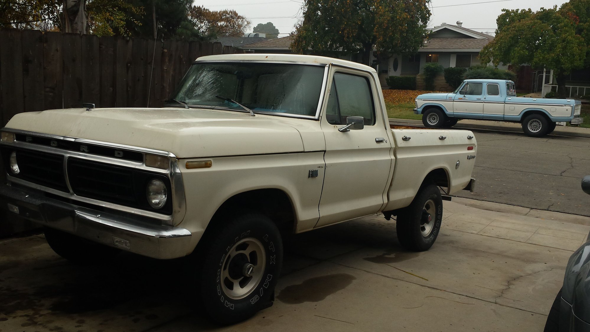

2vs4x4 they differ in other more important way. The 2wd has pigtail on bottom and regular top. 4x4 has regular top and bottom. Look up one of my lifted 2wd postings. Shows what I used to level my Supercab 2wd with a 460. compare. Last is my sons 75 we are starting to work on and mine in the background. If I had to do it again, I would put the taller lower spacer rather than the stock one that came with the truck. I had them but did not want to press my luck, as I had to n\have the beams bent to get the camber back to stock. The front is 1" lower than the back, the spacer would fixed that.

Thank You Mofoco1 for sharing your expertise and your pics. You are blessed to have your son involved. The pics show what appears to be good stuff.
My front coils on the '74 F250 300L 2x4 appear to have two pigtails, one each end, strangely. Because I'm going for a lower and softer ride I cant cut a coil off to try and level the truck chassis. I have however taken the two lower support leaves off the rear blade stack, which had seven blades , dropped the rear by by one inch, still have more than 12 inches of travel left.. The front travel between the rubber stops and the I-beams is 2.5inches. I am looking for improved cross axle flex to get the smoother ride and to prevent lifting of one rear drive wheel ( no LSD) to maintain maximum traction when I go off to the boondocks fly fishing .I also have no torsion bars, so cant rely on them to push the other wheel down. I'd appreciate any suggestions you have.Being in my 70's I don't want a struggle to get out of the boondocks, but I am convinced that with the right setup and careful driving practice I don't need a 4x4 vehicle.
