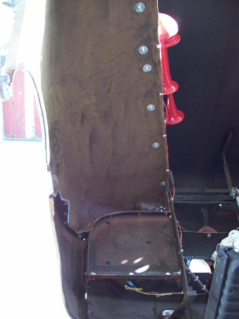

One thing you definately need to do if you are bolting hinges to the air deflector is install some sort of reinforcement to it or it will tear.
Pictures:
Name:  J1 Right Side Wind Deflector Tear.jpg
Name:  J4 Right Side Support Bracket Installed.jpg
Also, here is the picture of the back of my fender with the thick welt. The top one is how it sits when I lower it and it just contacts the top of the running board. You can see how little space there is between the fender and the cab. The black mark on the cab is just dirt and oil that gets stopped at teh welt - it washes off with 409 and water. I just get out and tuck it in behind the running board as in the second photo. There is no contact between the fender and cab as the front raises or lowers until I tuck it in then the contact is made by the welt only. The tension of the running board front point pushing in on the bottom of the fender keeps the fender pressed snuggly up against the cab. There is no movement, rattling, or exhaust blow by or paint scratching of any kind.
Final pic is from the top down. Note the small gap between the back of the fender and running board. Also, not the point of contact where the hook in the running board holds the fender in. There is a 2" wide piece of rubber sheet glued to the back surface of the fender between it and th erunning board. It is at teh contact point with the running board. I'm not sure the F-100 fenders are curved enough to do this. It seems to me that front edge is more diagonal and less curved.
Note also that with this type of carrier, the hood lifts over the frame and there is no need to cut it for clearance. When fully up, the front valance is about 1 inch from the top of the front bumper
Finally are the two pics of the roller and clasp I saw on the 47 Chevy - very simple.
The gray under the bracket is the concrete below - it's hard to tell. This is welded onto the front edge of the running board. The black strip onthe front of the running board is the velcro pad.

While th euse of th einner fenders surely adds weight, it also adds material to share in support of the whole front, and helps distribute the stresses that are imparted on the front. In my design, the air deflector had to absorb the entire torquing moment of the weight of the front and thus I think the tearing. But, my front does not have the inner fenders (no room withthe engine and exhaust I have) so it is VERY light - relatively speaking. When I reengined, I was able to get under it and lift it up on my back and walk it around to move it. So, less than 85 pounds I would think.
Even though you may not be considering changing out the engine more than once, I would definately consider the ease of access to the engine compartment for routine maintenance.
Also, I would not weld the panels together. If you get hit or have a problem, replacement will be very difficult. Mine is all bolted together and any part of it can be changed out in a matter of minutes. The original sheet metal works really well.
Just food for thought.....Heres a few more pics:
This fender swap took me four hours for both sides - and I reinforced all the bolt ups with new stainless hardware at the time and undercoated as well.
I like Toms Set up it looks really solid and strong!
