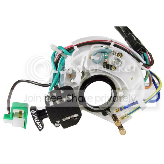

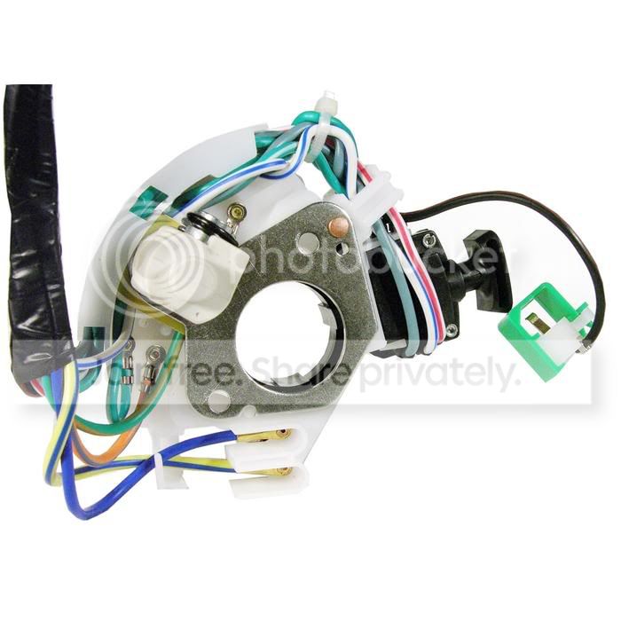

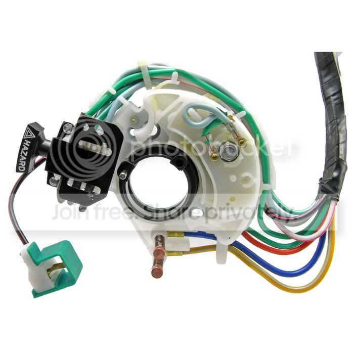

Whats the difference between these two turn signal switches besides wire colors, and the orientation of the black center piece, ( I think it spins anyway for the turn signal cancel function.). Both parts are for a tilt steering column. At Autozone, there is a $30 dollar difference.
This one is the correct one for my truck: (1986)
OEM #'s E5TA- 13B302- BA; E5TZ- 13341- B; F0UA- 13B302- FA
And this one is for an 1988:
OEM #'s E7TA- 138302- BA; E7TZ- 13341- B; F0TA- 13B302- FA

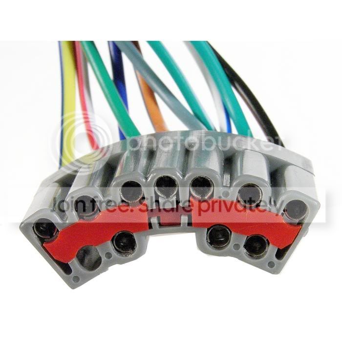

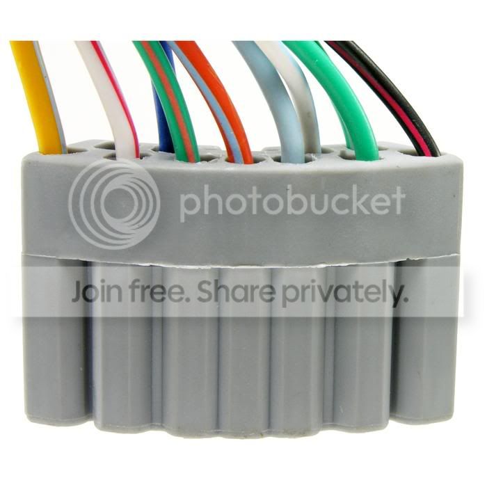

Ok so the one I was working on was the 13b302-ba out of a 1991 Ford F-150. I troubleshot with a test light to figure everything out and the wiring went as follows.
Green w/orange stripe = rear left turn & brake
Orange w/blue stripe = rear right turn & brake
White w/blue stripe = front right turn
Green w/white strip = front left turn
Yellow/blue to black/purple = horn
Light blue = turn signal flasher
White w/red stripe = emergency flasher
Solid green = brake pedal
The solid blue one I didn't end up using for anything. I thought it may have been for the high beam flash to pass but maybe my switch was broken. I didn't actually pull the steering column apart to figure any of that out. It was just trial & error. Hopefully this helps somebody else out there. It would have saved me a bit of time for sure! Good luck.
