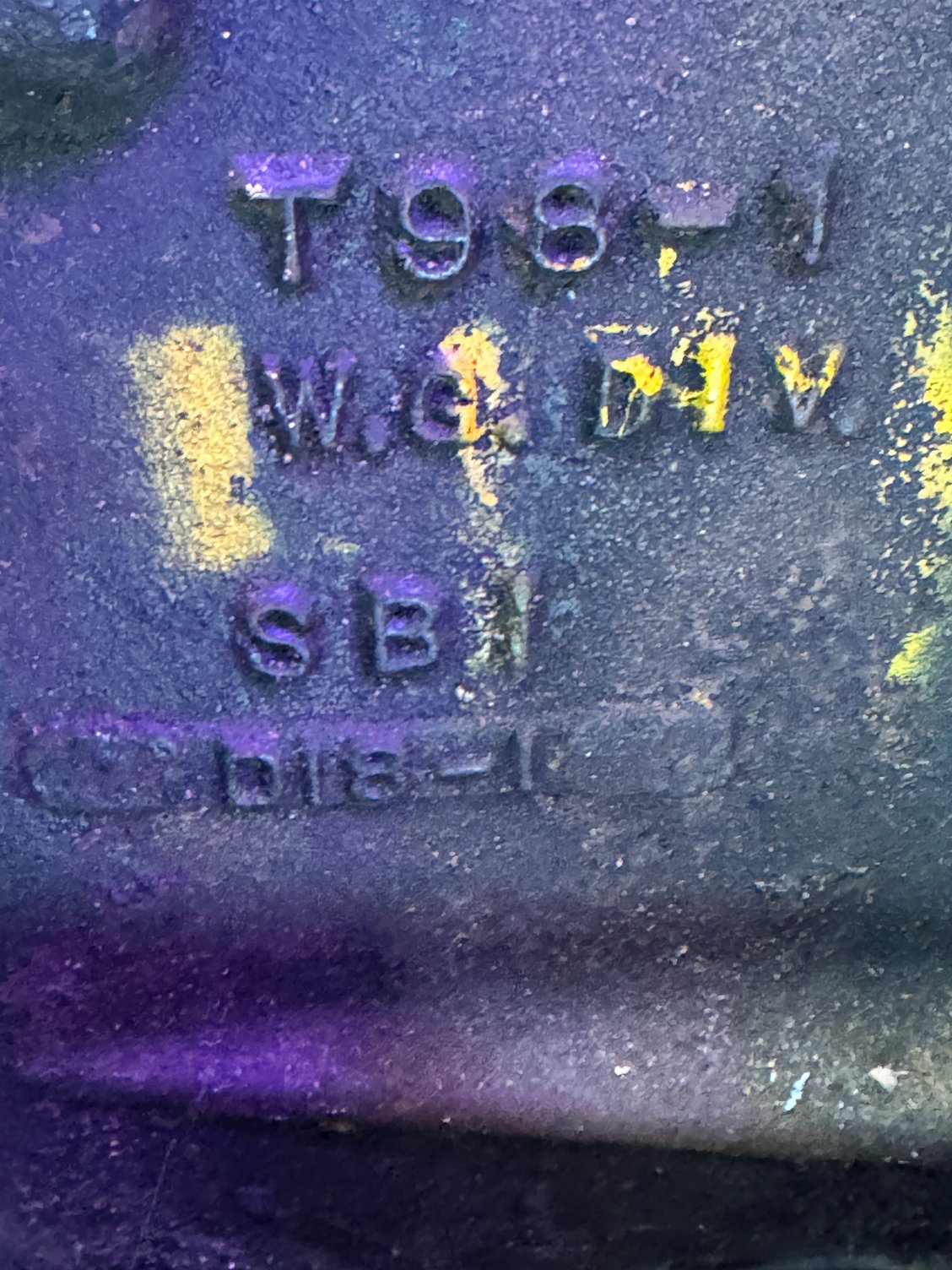

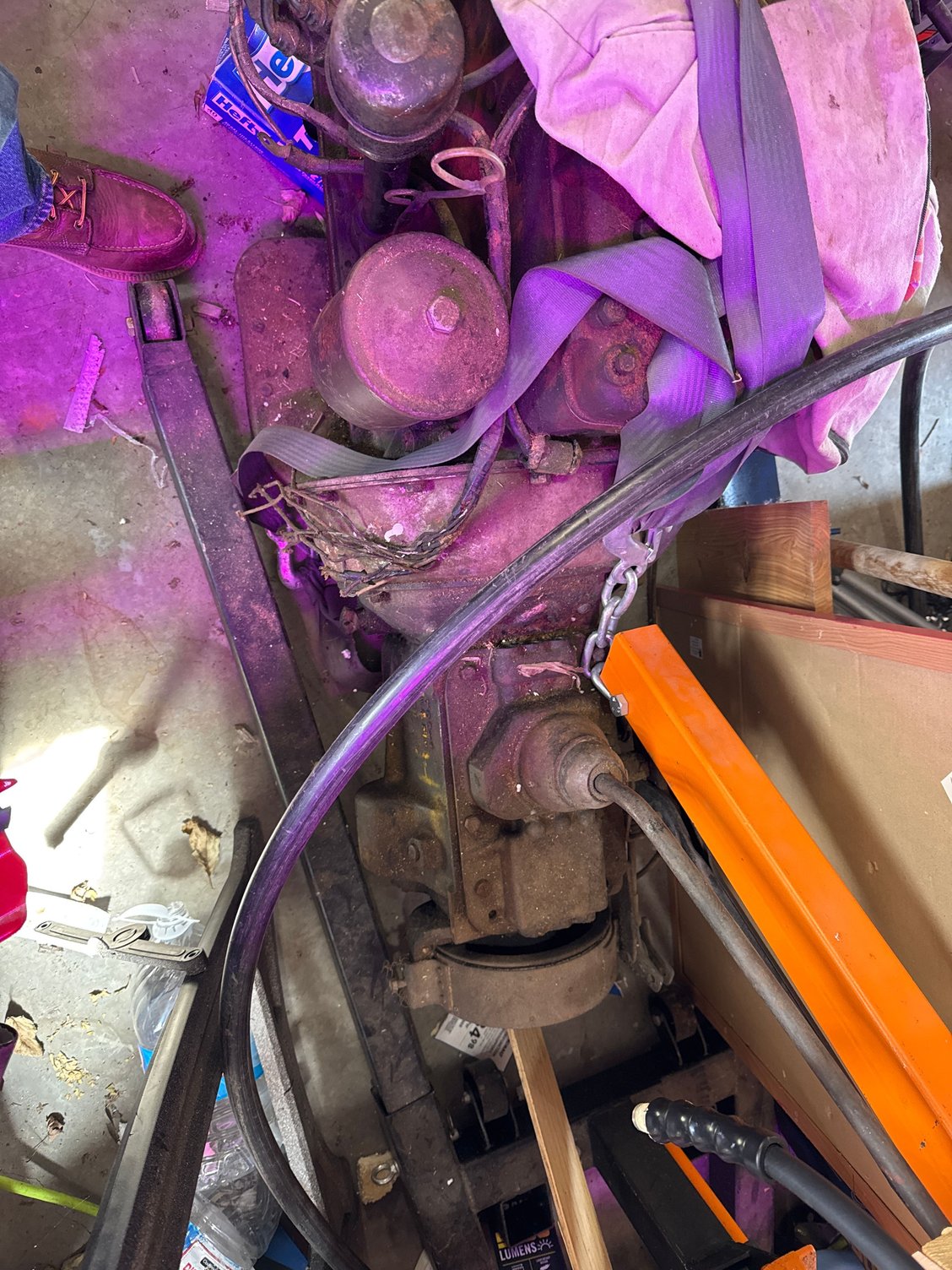

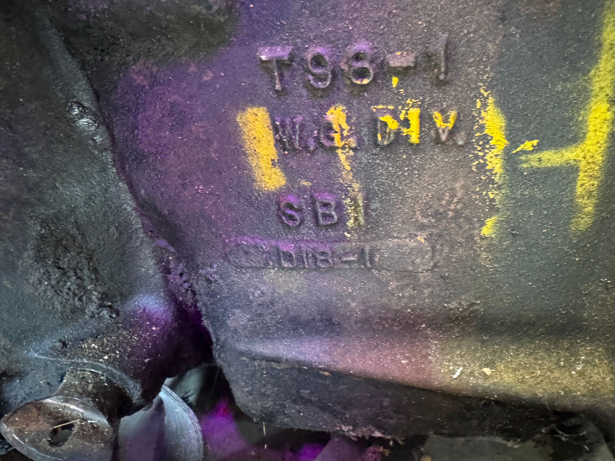

Originally Posted by reamer
I put a T-98 right behind my 239 flathead. bolted right up. had to shorten the driveshaft, bt thats it.
Reamer
Talk about finding an old thread.
Interesting, haven’t switched to a T5 yet and I have one of these behind a 254 out of an F6 sitting on my garage floor. My three speed is noisy. If I take the brake off does it have a normal spline like for driveshaft like an F1?

The T-98 you have is for the First Generation F4-F6 trucks. Many users seek this transmission out as a drop in to replace their crashbox. This is not to be confused with other T-98 variants.
However, the T98 was never offered and will not drop in to an F1 without some serious adjustments to the frame and whatnot:
https://www.ford-trucks.com/forums/1...o-1948-f1.html
https://www.ford-trucks.com/forums/1...nsmission.html
You can also learn here too (for the F2):
https://www.ford-trucks.com/forums/1...-an-f-2-a.html
Lastly, a F6 wouldn't have a 256 - I believe you mean an inline 6 254. For both the engine and transmission - don't scrap them - make sure they find good homes.
