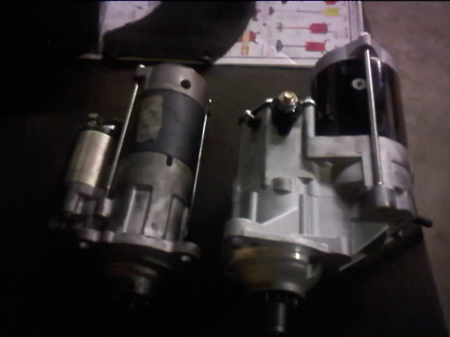

I got one of the Denso 'super starters' after getting SICK of replacing POS rebuilt starters - even if they were 'free' replacement. This thing ZINGS the motor over!! Had to clearance the crossmember a little for it to fit. Looking for a deal on another one for the X - saw one on fleabay for $150, but missed it.
Its ALOT bigger than the stocker:
