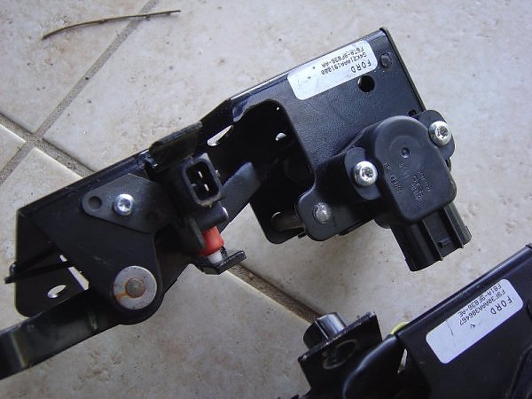

First check all the fuses . there are two switches on the go pedal, make sure they are plugged in ...
Name:  Go Pedal.jpg
Listen for a faint click when you push the pedal....

X2 Welcome.
If they are plugged in, unplugg them, clean up very well, put a little of dielectric grease and connect them again and make a try. good luck.

Thanks, I made sure all connections were tight, checked and tightened all fuses. Now it revs with pedal. But now it is idling a little rough. I'm going to drain fuel filter and see if that helps. Thanks again.
