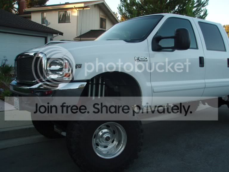

Hey guys, I don't post here much but I have been lurking around for while.
First off, I know these trucks don't get anywhere near good MPG, I bought it for towing, but I feel like I might be able to do better than 8....
I'm running an 8in lift with 38/15.5/16.5 Swamper TSL's. The truck was regeared for the bigger tires by Ford. The truck also has a throttle body spacer (it was bought with it). I'm currently getting 8.1MPG and want to try and bump it up even a little bit. Double digits would be very nice.
Any recommendation on bumping it up? I konw smaller tires will help, but how much smaller. Just going to a 37/13.5, will that be enough? Also I know there is a 5 star group buy right now, will that programmer help a little?
Thanks guys

Should be at least 4.88s with those tires. To me though 8 mpg around town isn't too bad with your setup. If your geared properly you should be able to pull 12 on a flat highway. A good tune would help the truck out but I don't know how much of a mpg increase you'll get with your setup. Any increase you get will probably be from premium fuel and strictly highway.

go down to a 37"s tire with a more street biased tread pattern...
as stated ur gearing still isnt tall enuf to get u in the sweet spot, the tires are to big...
p.s. i like ur pics gives me a good idea of what my truck's rear end will look like when i finaly get my 08 tailgate project done..
